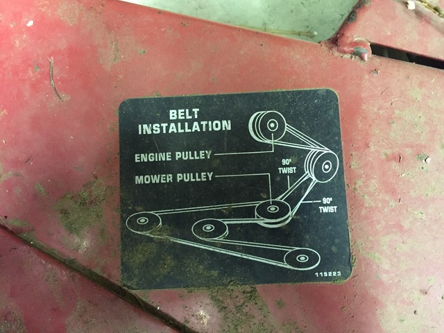

tommyg 157 #3 Posted September 21, 2015 My spindle belt rides on the top. The belt from the PTO is on the bottom, which is a bit of a pain when removing the mower deck, but that's another issue. Maybe this pic will help. 1 Share this post Link to post Share on other sites

gwest_ca-(File Mod) 12,450 #9 Posted September 22, 2015 Looks like the 115223 belt routing decal was used on all the 60" decks for the 520-Series.http://www.partstree.com/parts/toro/parts/115223/If the link does not work click on the More Details for ToroGarry Share this post Link to post Share on other sites
cheesegrader 436 #10 Posted September 22, 2015 Both of my 60" decks have the drive belt on the bottom, spindle belt on top.Both have the same decal showing this order. Share this post Link to post Share on other sites
