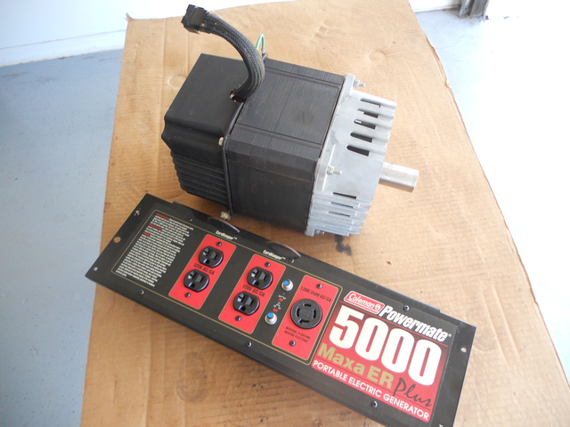

Racinbob 13,131 #4 Posted August 19, 2015 Actually John, directly coupled gensets don't have anything on the shaft side. The motor supports that end. Here's a pic of one I just sold. The shaft you see is actually part of the crankshaft that I cut off and there's nothing supporting that end.. I thought about a flange bearing but there wasn't enough length for a bearing that size (1 3/16"). I couldn't find a smaller tapered shaft and didn't have the machining capabilities to make one. With the right shaft a flange bearing could simply be bolted to the end of the case. That's good info on running a 10kw with a 14hp. The 5kw Wheel Horse unit I has was plenty for our all gas home in Indiana. It's a different story with this all electric home here in Florida but as long as I used common sense I got by. I just looked at the Harbor Freight unit. It's 10kw surge and 7.2kw running. That would be a great choice RickF. Share this post Link to post Share on other sites
