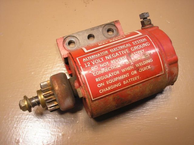

      Please Help-- I inherited this work horse from my father in-law after being passed down from his father.  I recently brought my wheel horse in for repairs and the service shop said they were unable to find the part; starter/solenoid.  I did not want to give up on this beast as even the repair shop said this is a well made machine and is better than anything built today. I eventually found the part but because the shop left the part uninstalled I was unable to see how the starter was wired.  Yesterday,  I installed the new starter/solenoid but when I connected the battery terminals the tractor wanted to start on its own.  I quickly disconnected the terminals and analyzed the electrical schematic map but I am baffled on the proper wiring.  I only have a positive (red) battery terminal wire, another red wire, black (ground) wire, and a blue wire with a slot connection.  I included pictures of the starter and the electrical schematic map.  Any help would be much appreciated!! I l would like to fix this on my own as this seems to be a simple wiring issue.  I can add pictures of the tractor itself, but at the moment its under a tarp in a shed at night. Thank you in advance, Matt
