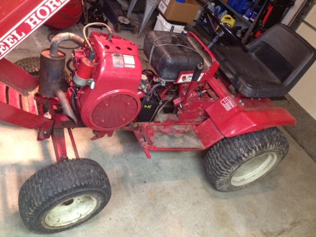

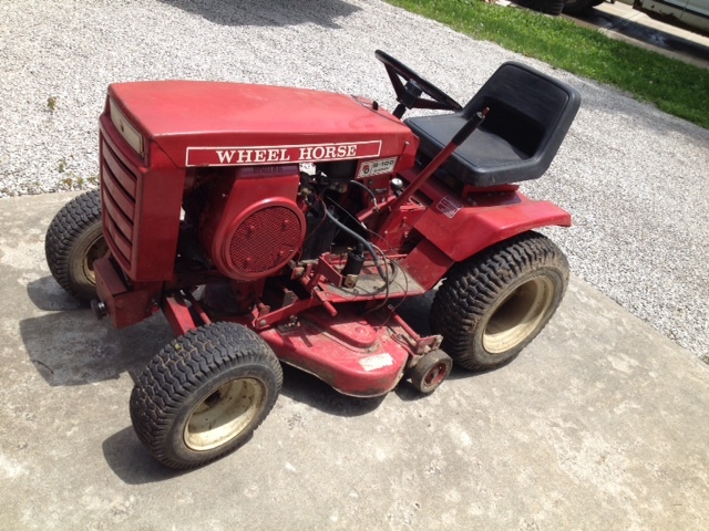

TDF5G 2,072 #14 Posted July 28, 2015 I'm at work. I can't get the video to attach. I shot a 30 sec video of it running right after it fired up. All I have is this pic the day I brought it home. The hood wasn't attached and the engine wasn't bolted down and you can see the cables, fuel line and coil on the foot rest. PTO parts and points & cover were in a box. The crank pulley and the retainers were missing along with the points push rod. As was the pto hub thrust bearnig, washers, & spring. It didn't fire right off. The fuel shutoff was clogged up with rust, but the tank was clean. Had to readjust the points and she fired right up. Need to fine tune a few things. Hopefully, I'll sharpen the blades and check out the deck and try out some mowing in the next day or two. 1 Share this post Link to post Share on other sites

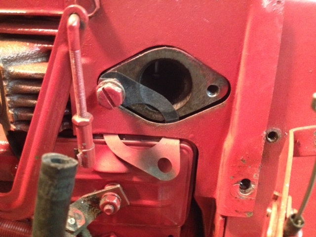

TDF5G 2,072 #18 Posted August 10, 2015 (edited) I've had trouble getting the B100 to idle smooth and the governor "hunts" as they say. Had to adjust the choke with the throttle to get it to run smoothly at various RPM. Just messed with it a few times when I had the chance. I'd warm it up and twiddle with the carb set screws. I decided to clean the carburetor so I ordered a carb kit. It was raining Saturday morning, (or I'd a went to a swap meet) so I pulled the carb off and saw this (see attached pic). Someone slipped up putting the carb back on after the overhaul. Put a new gasket on and now she runs real sweet! It idles good and smooth now and the governor seems to be happy. I like easy fixes! A lot of times it's just something simple, ain't it? I was so happy I took it for a ride in the rain! Edited August 10, 2015 by TDF5G 1 Share this post Link to post Share on other sites

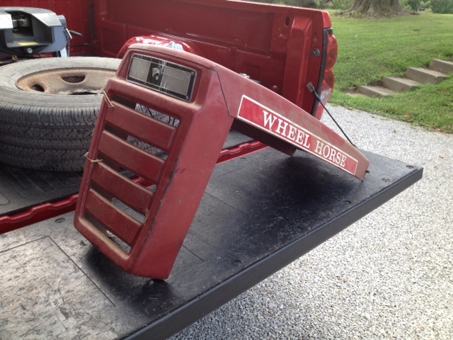

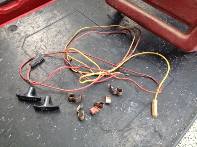

TDF5G 2,072 #19 Posted August 10, 2015 Sunday after church, the topic of Wheel Horses came up again. One of the fellers said he had an old 12 HP, if I needed any parts. He had bought it years ago for the engine, in case his '72 Raider 12 gave up . He said I could have anything but the engine and transmission. So I got the hood with lights and some knobs. My B100 will get lights now. But he wouldn't let me have the light switch. I can't figure why unless he thought he might need it someday. His Raider has headlights. 1 Share this post Link to post Share on other sites

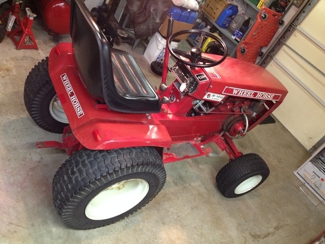

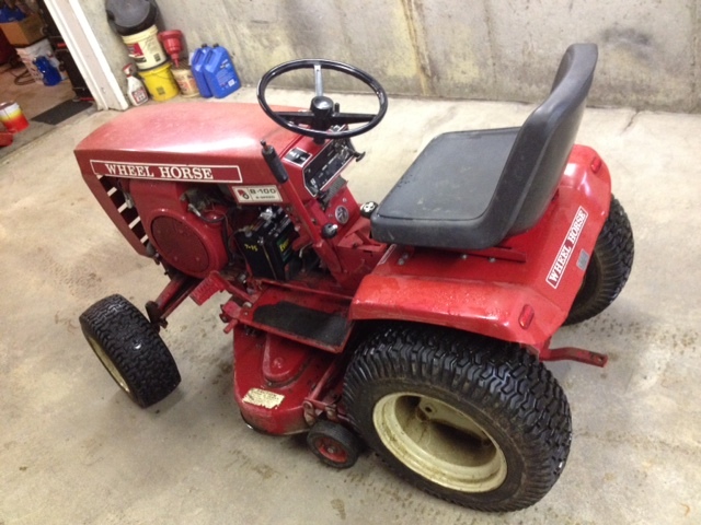

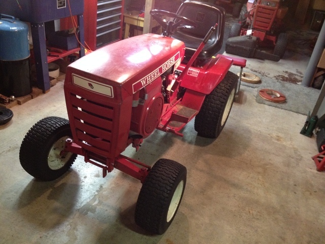

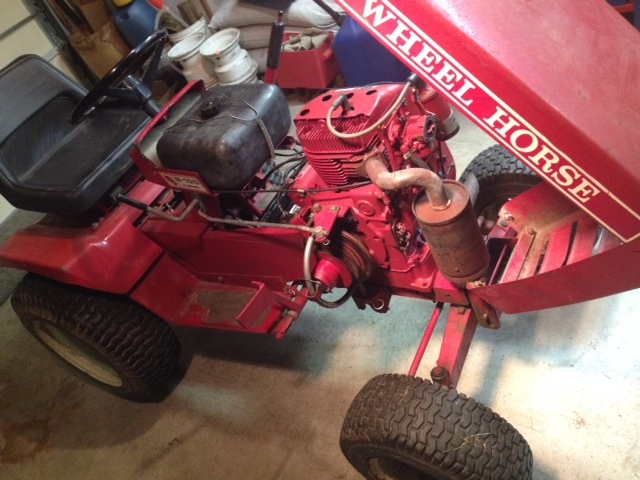

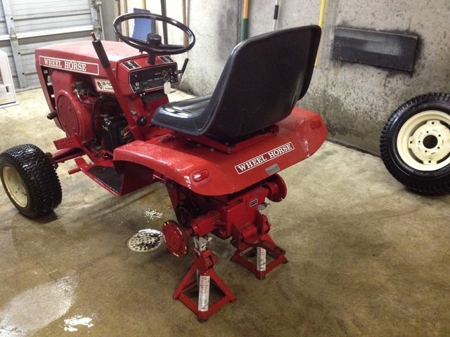

TDF5G 2,072 #21 Posted October 23, 2015 (edited) Sorting out pics today and I realized I never did post these when I intended to. More pics of the B-100 I got this summer. I'm hoping to get her cleaned up, install the lights,and try her out pushing snow this winter.Too many other projects are getting in my way. I've got the dishwasher torn apart right now. Edited October 23, 2015 by TDF5G 1 Share this post Link to post Share on other sites

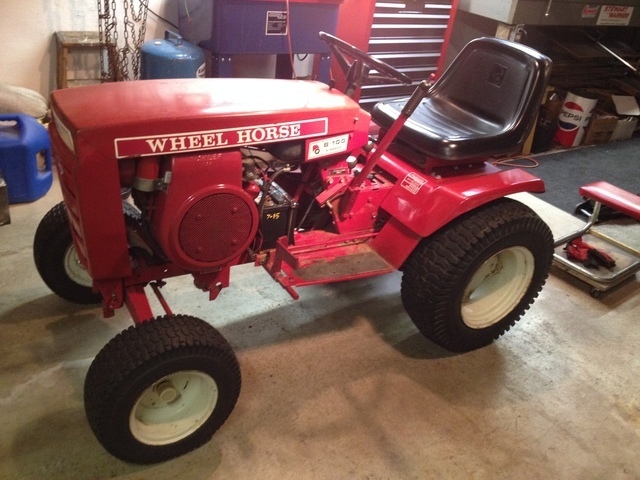

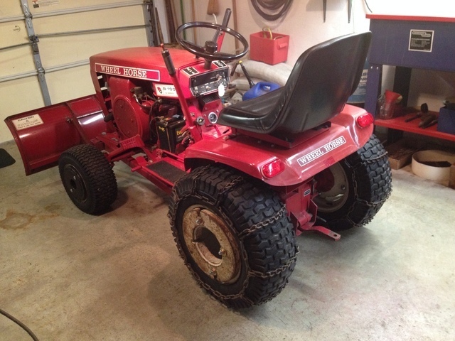

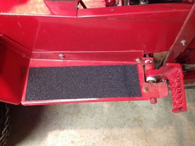

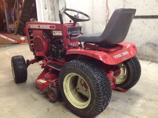

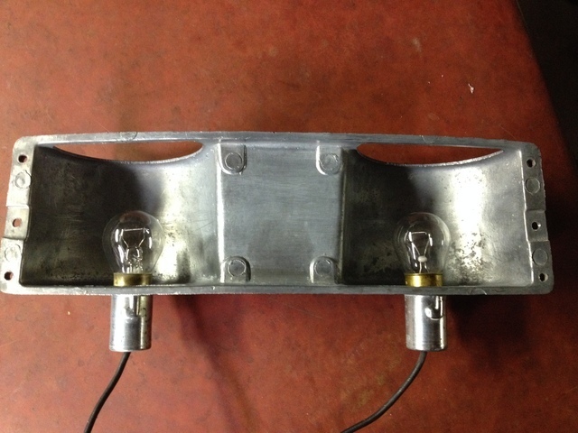

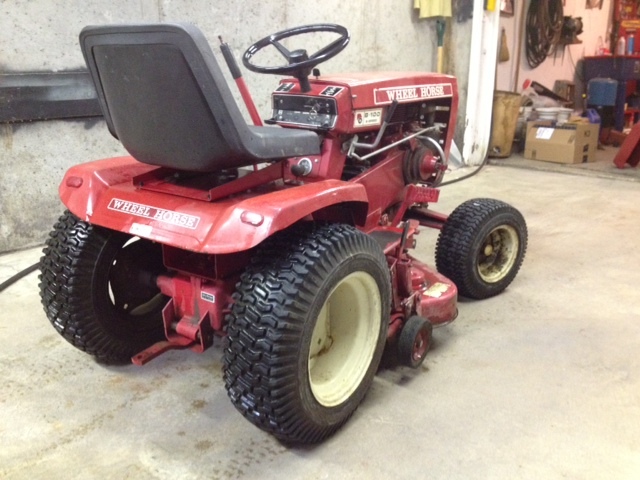

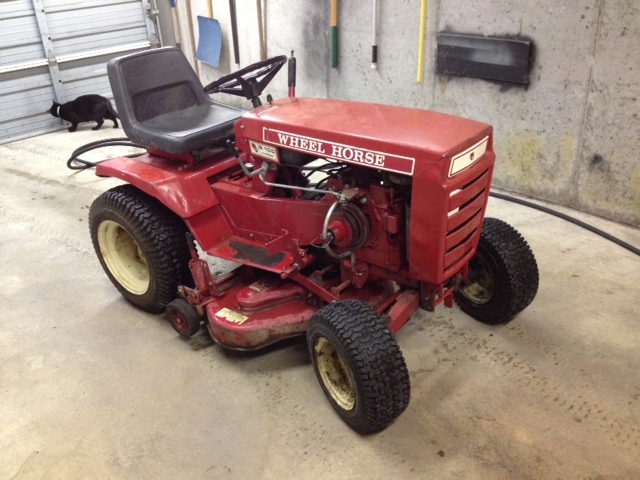

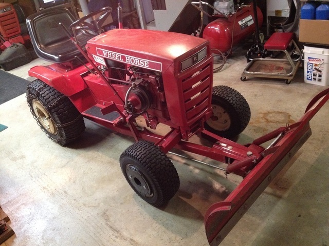

TDF5G 2,072 #22 Posted February 23, 2016 (edited) We like pics on the RS so here's some more I found for ya! B-100 UPDATE: She runs great now after carb tweaking last fall. Got 'er cleaned up and did maintenance on it. Replaced foot rest pads with skid treads that I found at Lowe's cut down to original size. Replaced missing Tach-A-Matic and lift handle plunger rod caps. Swapped rear tires and wheels for larger 23-850s from my C-105 and installed chains and wheel weights. Installed headlights and added tailights. Put on a WH highback seat. Attached the dozer blade and waiting for some white stuff now. We've only had 5" total for the season so far. I'd like to try it out now in a good 6-8" accumulation! Edited February 23, 2016 by TDF5G Share this post Link to post Share on other sites
