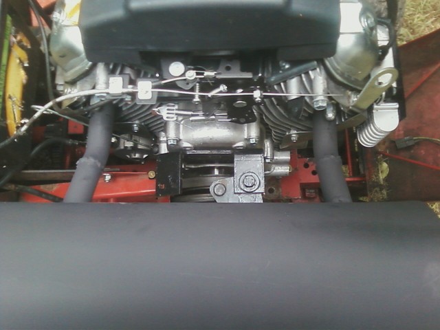

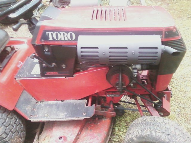

Woodsie 51 #12 Posted July 17, 2015 Here's some low quality pics. She aint a showpiece! Huge honkin muffler. That was the hardeest part. Hood is tight fit.Dont comment on my exhaust braze job. 16 Share this post Link to post Share on other sites
bmsgaffer 2,046 #13 Posted July 17, 2015 That looks great! Nice job.Do you have a picture from muffler side with hood down?Can you detail your modifications you made to the various brackets? (or at least take pictures?) I'm always curious what a repower would take.Doesn't need to be a show piece, sometimes you just need functionality over form. Oh and I would love a video since you have the stock HF muffler. Share this post Link to post Share on other sites
Ed Kennell 40,484 #14 Posted July 17, 2015 Looks great.... This is definitely the way I will go if / when my 220 loses a valve. Can we see a close up of the PTO upper mount? 1 Share this post Link to post Share on other sites
JoeM 7,928 #15 Posted July 17, 2015 how's the engine crankcase noise?looks like you had to raise it up an inch? Share this post Link to post Share on other sites

Woodsie 51 #19 Posted July 17, 2015 OK, here goes a long post.........Crankcase noise? Less than old Onan, but doesnt purr like a Honda. Muffler is Ginormous but not that quiet.Am I really the first person to do this?? If I did this . Anybody can do this. (especially after i give all the details)Measure , Measure , Measure before you take old motor off. Height , width, distance from here to there. The more reference points the better.HF shaft is 1.3" lower than P220. I used 1.25" aluminum (the miracle metal) blocks. Easiest to drill thru. (7/16 Holes)HF shaft is near exactly 1"Dia. P220 1 1/8" Dia... Thus you need a piece of steel tube 1 1/8" O.D. 1" I.D. (Online Metals. get at least 1' I will tell ya why later). However,closest i could find was .992" I.D. Had to use a 1" bore thru. Keyway slot needs cut in new tube to match slot in HF shaft. 1/4" key. You have to use 1/4" X somethin bigger key, cause you have increased the needed height by putting that sleeve on there. In other words to go up into drive pulley far enough. Oh longer set screws too. The length of this sleeve... sorry i didnt write it down.You gotta guess like i did by putting the PTO cone on. You have to be sure you are past the length of that heavy steel bushing or whatever that thing is called the needle bearing travels on. I unbolted the original motor plate and put the 1 1/4" spacers under it. I contemplated that, big time, whether to leave the original plate there and put spacers under it, or space the motor on top of the plate. i didnt feel right about the motor sitting on little blocks, so i spaced the motor mount plate up. If i had spacers and another plate i might not have gone the route i did. Have your front belt tightener pulley thing on the tractor for the east and west motor alignment. Have your PTO on and place a belt over the pulley. Make sure it doesnt ride on the cone flat disc face. Use all those measurements you took for north and south. Obviously you have to drill new holes in motor mount plate to match HF motor mount holes. (i used a 3/8" dowel rod about 1 1/2" long with paint on it to mark new hole placement. you dont have room for anything like a marker or center punch.)Upper PTO mount I simply had to weld 1" to its lower extremity to meet with HF bolt holes. Had I put the motor up on spacers and left the mount plate there I "might" not have had to do this.EXHAUST SUCKED! HF muffler dumps right in your face. Cannibalized new muffler and old, to flop everything around. Oh you can used leftover 1" tube to lengthen pipes to clear PTO and hood. Same size as exhaust pipes. .............. You figure it out. I did. Throttle and choke simply undo old/new ... hook old/new up.HF comes with a "control box" take it apart lengthen wires drill bigger hole in dash for ignition switch. SIMPLE STUFF.Obviously I got rid of ALL BS guages. Might try to hook up voltmeter.Fuel line SINCH. Battery SINCH.The hood is tight. I need to raise it. The hood louvers cut into the HF air filter top. I have a rag on it now. Muffler touches side of hood.GO FOR IT! All you guys that never cleaned the cooling fins on your Onan. I bought this one for $150 only because it had new back tires.All you Wheelhorse purists, is this like puttin a Chevy motor in a Ford? Or worse?If anybody needs more info, not sure if my e-mail address shows up to everybody, but feel free. 11 1 Share this post Link to post Share on other sites
