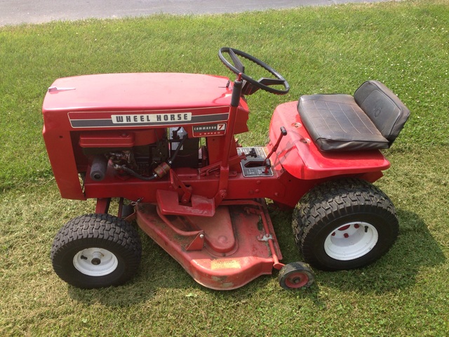

I put a mower deck on my Commando 7 and it worked fine at first, but then the blades wouldn't disengage.  Suggestions?

Thanks for the reply but unfortunately I have the other commando 7.  Strange how it worked at first but then wouldn't disengage. Stalled the mower a couple of times at first too so maybe the belt is too small????

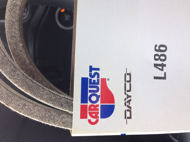

So the belt I have on now is a gates 1/2 x 85. According to the manual I need a 1/2 x 86. It says I need toro #8412. I think I'm reading that right. My model is 5-7361.

I am 99% sure this belt needs to be fabric covered and if it travels over a flat idler it should be a green Gates belt. They are designed to bend backwards because the cords are more central to the belt depth.

This is what they gave me. I gave them the Toro part #. BTW thanks Garry.

Just wanted to finish this post....the new belt works.  There are two holes on the mower deck that the hook for the lever goes in to.  Didn't work when I hooked it to the front hole....worked when I hooked it to the rear hole.  Thanks again everybody.  Sorry it took so long to give an update.
