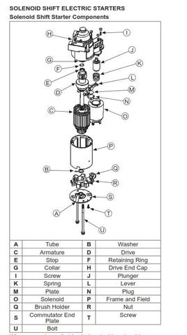

Here is the Kohler service manual
http://www.wheelhorseforum.com/files/file/2226-engine-kohler-command-ch18-25-sm-2469006-revcpdf/
Item K was the spring I was thinking of. There is another one at the end of the starter drive gear.

Garry mentioned a spring on the plunger, so I started looking at whether the solenoid plunger had spring pressure. It did.  I noticed the plastic fork in the starter had a notch in the center, and the plunger on the solenoid had the sides flattened except the end, so I figured out the plunger must fit into the slot in the fork in the starter. Put it back together, and success.
