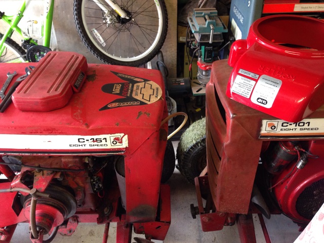

Lets see the 16 horse single! (Best C Series Ever)!
Horse46
Ha ha of course you guys love the pictures.
It's not much to look at, and not even sure of the future for the rest it yet. Sell or keep?
Only one picture as I will probably start a new topic for my plan if I go ahead. image.thumb.jpg.fc633572e26f493e854b8ac9
