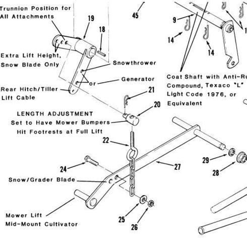

semper5 43 #2 Posted June 11, 2015 I see lots of people viewing this, but no replies... Maybe if I clarify my question?There are a few links dangling off the hydraulic lift arm located center frame, where the deck attaches. When operating the lift, nothing happens. It appears the chain may be too long. Is it a good practice to move the bolt to a different link to 'shorten' the span, so it will affect the deck, and lift it? The pin that goes into deck is attached to the chain via a bolt and lock nut. Share this post Link to post Share on other sites

semper5 43 #4 Posted June 11, 2015 I stuck my heart under the tractor today, realized there are 2 arms which could be used... I chose the higher arm, and began to slowly replace pieces... (Trunion, eye bolts). Perhaps the prior owner used the wrong lift arm for the deck? Share this post Link to post Share on other sites

shallowwatersailor 3,213 #7 Posted June 11, 2015 (edited) Does this help? You need to have it attached where it says "Trunnion Position for All Attachments." Edited June 11, 2015 by shallowwatersailor 1 Share this post Link to post Share on other sites
semper5 43 #8 Posted June 11, 2015 Thank you Shallowwatersailor!! Perfect! Share this post Link to post Share on other sites
