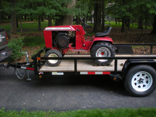

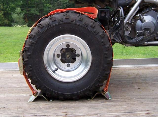

Yesterday I received the Pack'Em straps and chocks that I am using for "placement." I am using one per tractor. They have an 800 lb. capacity per set but I will also use flush mount D-Rings for strapping them on.
I haven't decided whether I will haul the tractors backwards (safer loading) or frontwards (less chance of the hood/seat flying up.) Has anyone ever done a weight-bias measurement?Are tractors heavier towards the rear? The Pack'Em system is bolted to the floor with a strap around the tire. The rear tires size/axle width is more consistent with the Ride-Ons so I am leaning towards hauling backwards. When it is the Bee-Hinds turn for a road trip, I will just use the D-Rings I guess.
Edited by shallowwatersailor
baerpath
I've never used Pack em straps but don't think I'd like them I want my floor to be flat not have bumps when I haul other things or even other sizes of GT's  That's still just another version of E track with chocks

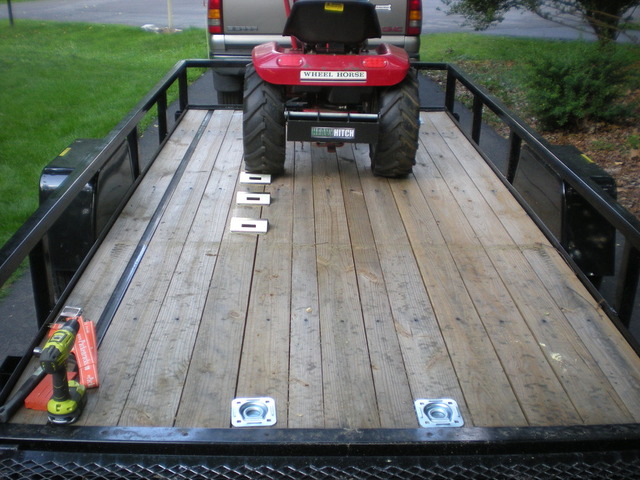

I started installing the D-Rings on the floor. So far the front and rear ones are in place but not bolted on. I plan on staining the deck and want the wood underneath to be protected as well. It turns out that the 5xi is a smidge too long to also carry a classic Wheel Horse. I have to admit that I was a bit concerned about the combined weight as well. I guess I should have bought a tandem 6'x14' to do that.  Oh well, next time. :)
Here is the 523Dxi up on the trailer (actually too far forward), and my C-105. My plan at this point is to install 4 more D-Rings centered to strap the rear ends down. It looks like I will use the Pack'Em straps in different sequences. 1st-2nd and 3rd-4th to hold two classic WH back-to-back, and either 2nd-3rd or 3rd-4th for the 5xi. They will provide a fifth point of securing the tractors.
DSCN3182.thumb.JPG.c0dfe6991657f7e21a65aDSCN3185.thumb.JPG.b26ce52a844785912752fDSCN3184.thumb.JPG.d7be3a673d3a25ba46fcd
