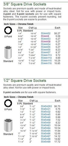

 3. Where can I find the special (I think it is an 8 point socket) for the set screws.

If you want the socket you can order the correct 8 pt socket from Napa. Be careful on the key size.. I bought a 73 12 from the original owner who swears that no axle work was ever done. The tractor had 2 different size keys..

Definitely get the 8pt socket. It makes a world of difference. I couldn't keep mine tight until I got that socket!
