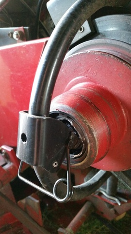

Steve W 0 #1 Posted May 28, 2015 Hello everyone. This is my first post to the forum although I have been reading alot of the posts after I purchased a 1987 310-8 about a month ago. I put on a new toro pto belt, and the clevis pin on the pto and mowed the lawn last week without any issues. Although it was noisy when the pto was engaged for the mower deck. Today I started mowing and the noise seemed to get a little louder and then the pto stopped. I immediately disengaged the pto and found what looks like a broken pto shaft. Any ideas on why this happened and how many more parts I will need to purchase now. Thanks for any input you can give me. Share this post Link to post Share on other sites
rmaynard 15,265 #2 Posted May 28, 2015 Looks like you will need a few new parts. The bearing probably seized and caused the damage. Here is what you will need:# 33, 34, 35, 35#33 - 102872 Shaft#34 - 32120-72 Snap ring (2)#35 - 32120-62 Seal#36 - 109842 BearingTake the pulley/housing off, pry out the seal, punch the old bearing out from behind, install new bearing, put snap ring on rear end of new pto shaft, insert it from behind, install front snap ring, install new seal.Put it all back together and get back to mowing. 4 Share this post Link to post Share on other sites

rmaynard 15,265 #5 Posted May 29, 2015 As long as it spins freely, it should slide right off after you remove the brake pad assembly. Share this post Link to post Share on other sites
Steve W 0 #6 Posted May 29, 2015 Ok guys my problem went from bad to worse this morning. After I pulled the PTO bell off I looked at the bearing and I could see it was really shredded and jammed in there. As I pressed the mangled bearing out of the PTO bell the bearing finally broke free but as it did it busted a big chunk of the PTO bell out as well. Some of the bearing is still stuck in the pto bell, but I won't bother with removing it because I will need a new PTO bell and inside bearing anyway. I thought that a boat was a big money pit, but I'm finding this to hold true with my wheelhorse project now as well. Dave I sent you an email too. Share this post Link to post Share on other sites
