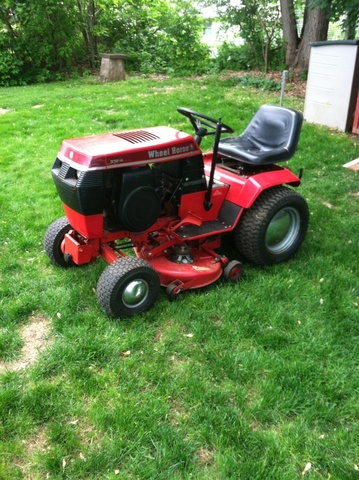

here's a pic. Also the blades are actually 18.5" makes more sense considering the deck is 37".
Original blades from Toro 109079 is a 2-blade set
Napa 2 of # 7-04724
Oregon 2 of # 91-817
Hole 3/4in. round
18-3/4" long
Have never seen a mulching blade for these.
