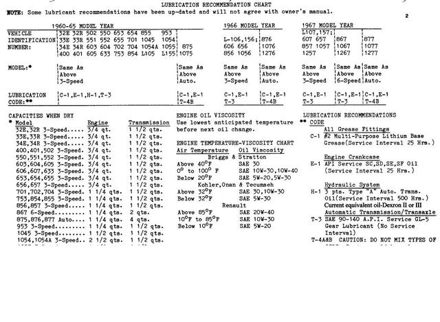

Dhodge 528 #1 Posted May 21, 2015 The manual states 4822 Wheel Horse oil only. What's everyone using? Share this post Link to post Share on other sites
gwest_ca-(File Mod) 11,121 #2 Posted May 21, 2015 This is from the lubrication chart. Look at H-1Garry Share this post Link to post Share on other sites
