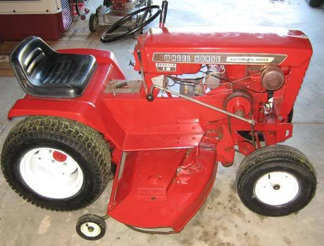

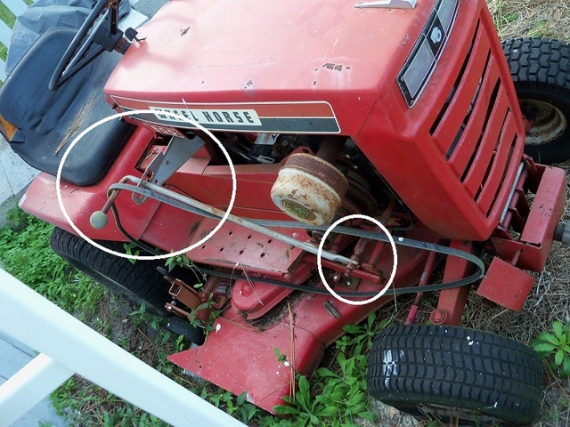

daveoman1966 3,762 #2 Posted May 21, 2015 So, you want to regress... to what is circled in this pic. The 2nd pic shows the setup on a Charger 12, but it is all the same. You'll need the hoodstand bracket, long PTO lever / rod and the STUD that mounts in the engine block. I have these. As for the foot pegs, they older ones should fit on the 3/4" frame rod that your foot rail is bolted to.for more info, contact me OUTSIDE of this forum. my direct email is:daveoman@windstream.net Share this post Link to post Share on other sites
