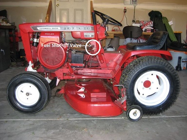

wheel horse men 9 #1 Posted May 8, 2015 Looking for some help I have a Raider 12 and the gas shut off valve on the side of the tractor is leaking. Is there a replacement valve for this? If so where can you get one? Share this post Link to post Share on other sites
daveoman1966 3,738 #2 Posted May 8, 2015 (edited) You mean this shut off valve... this is a charger 12, but probably the same thing. You can get a new one on-line for about $40. OR.... I have a used one for $27....SHIPPED to USA zips. My direct email is: daveoman@windstream.net Edited May 8, 2015 by daveoman1966 Share this post Link to post Share on other sites
JPWH 5,987 #3 Posted May 8, 2015 TSC stocks a 1/4 turn for about 14.00. I don't know if it would be an exact fit in your existing hole. Share this post Link to post Share on other sites
ol550 830 #4 Posted May 8, 2015 Why not take it apart and put a new o'ring on the shaft? 1 Share this post Link to post Share on other sites
baerpath 517 #5 Posted May 8, 2015 Why not take it apart and put a new o'ring on the shaft? That's all I did when the one on the GT14 started leaking 25 cent O ring Share this post Link to post Share on other sites
wheel horse men 9 #6 Posted May 9, 2015 Thanks for the help guys didn't realize there was a O ring in there looked more like packing will have to try that. Share this post Link to post Share on other sites
