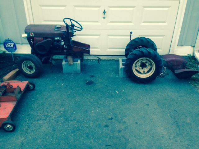

pacmanfan1977
Just a quick update, I did get the rear mounting bracket repaired/ welded. It seems to be holding fine, so now I can get back to looking at the grinding gears! I plan on making the part that attaches to the belt guard, and I hope that will resolve the issue. Here is a picture from when I repaired the bracket:
