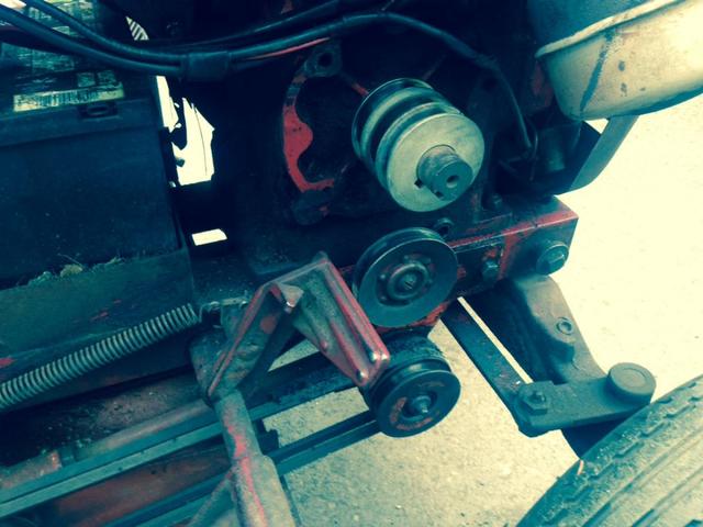

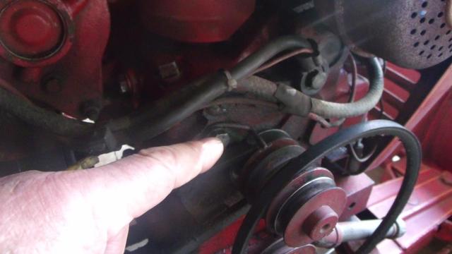

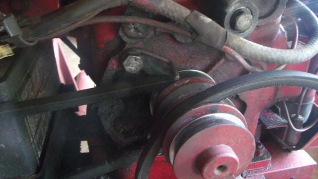

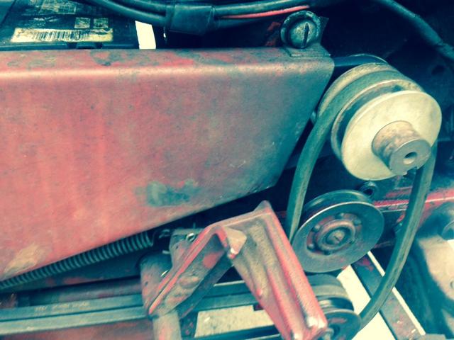

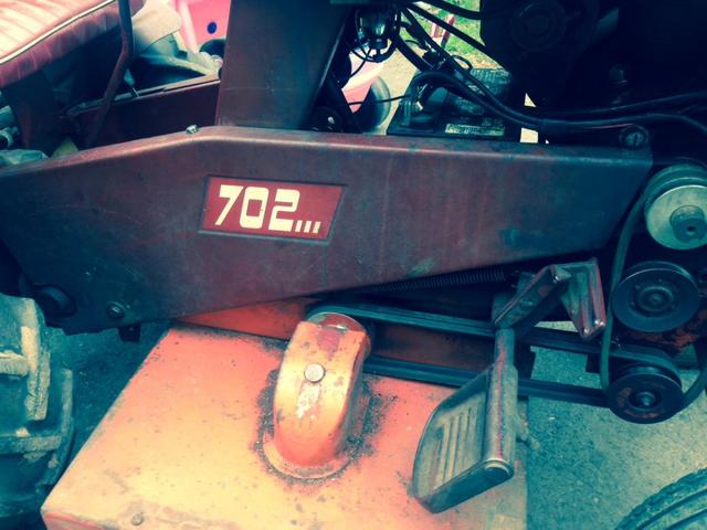

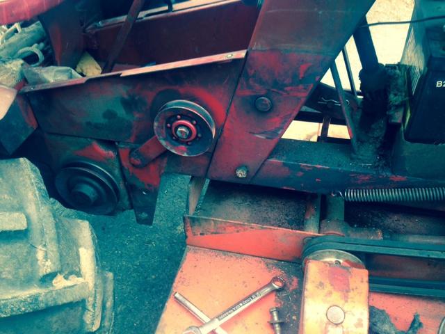

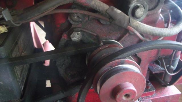

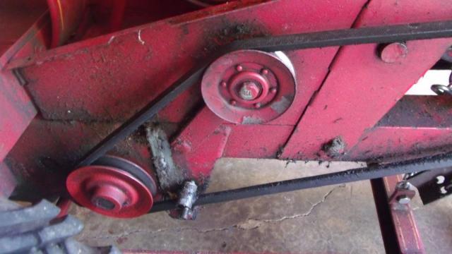

I tinkered some more last night without sucess...I tried cleaning up all the pulley's and made more adjustments to the belt guard but mothing seemed to get it right. It actually did work correctly for a bit, but after a lap or two around the house it went back to grinding the gears. Here are some pictures, maybe I'm missing something?

Isn't there supposed to be a belt-guide tab on the clutch pulley? So that when you push in the clutch the belt wont fall off, and it pushed it forward to get it off the engine pulley.
You would have had to remove it to change the drive belt, could you possibly have set it somewhere and forgot to reinstall it?

Well, I think I found your problem.  :bow-blue:   I pulled off my 702 guard and there are no tabs on the inside of the guard.
The 3/8" bolt that helps hold the guard on has a roller on it.  This would act like a tab. I have no piece of metal bent over the idler pulley to hold the belt there.
This is what you are missing.  I have a tab made out of like 12 or 10 gauge wire that is attached to the engine by a short 3/8" bolt.  The height of the wire from the belt is adjustable and is about 1/4" to 1/2" above the belt.  Although, I do not have one below the belt at this point...there is another bolt hole and another tab could be made to fit there.  :)  Hope that helps.

you are missing the front belt tab on the belt cover  I am not at home so I can not post a pic of it

Yes, I was thinking that Brian...I know exactly what you are talking about.  It is a flat piece of metal that extends forward from the bottom of the guard.  :)  If you have a picture, go ahead and post it Mate.  :)  Doesn't look like Mark has that on his guard either.
Brian, are you sure one of those tabs is on the 702 guard??  I just went out and looked again...I see no evidence that anything like that was ever there.  In fact, the bottom of my guard finishes with a 45 degree angle...I would think it would be a 90.  :eusa-think:
pacmanfan1977
Thank you so much for taking the time to pull your cover off!! You are right, I am missing the front tab by the engine. It also appears that I have the wrong hardware for my belt cover. The bottom hole on my belt cover was fastened by a nut and bolt. It looks like your has a fixed stud, with a roller on it. I feel that we likely found the problem. Thanks again for looking at yours. Now I have to find or make some parts!

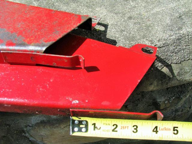

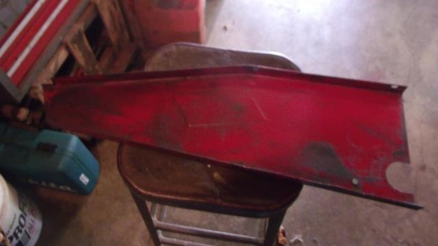

701 and 702 may not have had the tab probably started in 63 he could put a belt tab like you have on top under the pulley it should work the same as the one welded to the belt guard
not that great of a pic you can see the tab under the belt
Brian

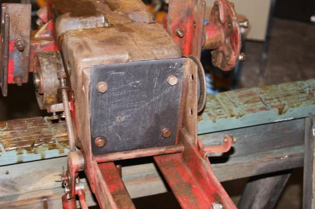

Well the plot thickens... :roll:   I went to take another look at the tractor and I noticed that while riding on it, the back felt kind of loosey-goosey. I decided to lift the rear of the tractor to take a look, and I've found another problem. The frame/ plate that mounts to the rear is cracked. I see this is a common problem with these tractors, and several people have posted their fixes on it. I have a welder, and I plan to repair the cracks, but I also see that people have added a stiffener/ secondary plate to make it tougher. I think I will fix this first, then tackle the drive belt issue....anybody got dimensions on the size of the plate? I want to make something like this:

You want to mount a 1/4" plate on the front of the existing mount...toward the front of the horse.  This keeps the length of the belt and linkage the same.  The only difference is adding 1/4" to your mounting bolts for the transmission.  :)  Not to mention...this could be most of your issue.  Obviously...fix this first.  :bow-blue:  Depending on the cracks and how bad they are...you could just "v" them out and re-weld...would last another 50 years.
buckrancher
6 1/2" x 6 1/2" square Plate
I used one that was 1/8" thick

I think I am going to repair the cracks, and then have a plate made. I have the 6 1/2 x 6/12 size dimension for the plate, but I was wondering if anybody had the hole pattern measurements? I have the ability to get a plate made today, but I haven't torn the tractor apart to take measurements. I know it's kind of a long shot, but does anybody have the hole placement/ size measurements that go on the plate handy?

I think I would fit the plate and then mark and drill the holes.  :)
buckrancher
I drilled the holes thru from the back side after I welded the plate in using the old holes as a guide

This is the guide you're missing from your cover.
