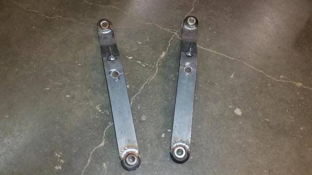

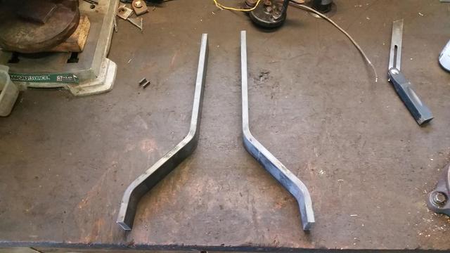

jeremi3210 741 #1 Posted May 1, 2015 I've been looking for 3 point arms for awhile with no luck so I decided to build them. 1/2 by 2 steel, and four weld on cat 0 ends. A little time with a press. What do you guys think so far? 5 Share this post Link to post Share on other sites
fast88pu 3,325 #2 Posted May 1, 2015 They look good Share this post Link to post Share on other sites

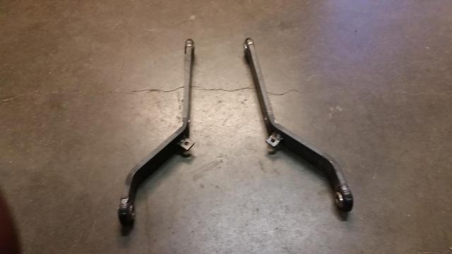

jeremi3210 741 #3 Posted May 2, 2015 Got the arms done. Now got to figure out the lift links. Anybody got any suggestions? 1 Share this post Link to post Share on other sites

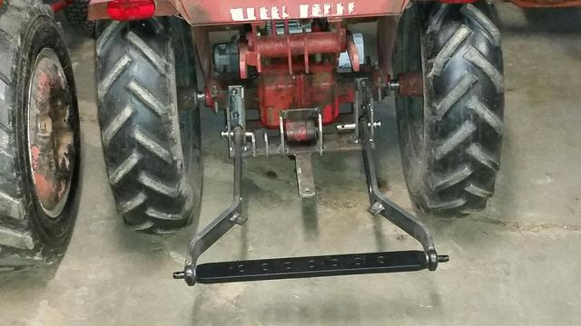

meadowfield 2,650 #4 Posted May 2, 2015 Good work, I've made two of my own so far. The first set was for my GT14. For the lift I used turn buckles and rose joints. Here's the last set I made. Share this post Link to post Share on other sites
