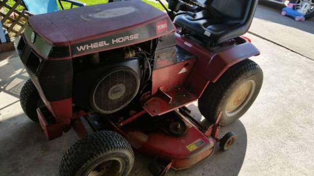

Got her in. Leaks some oil, reverse is pretty slow but she runs. Looks like it still has the original fuel filter  :eek:

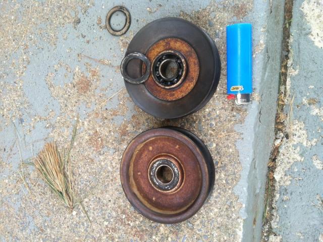

???? Need a part number on/for the V-pulley on the front mule (one next to lighter). Looks like a 7/8 ID & 4 3/16 OD. ????
Anyone have a cross reference for say a NAPA, or KOI...
Oh, & the dude I spoke with at TractorSupply was worthless... uh, "we don't have toro part." Well do you have ANY pulleys? "No"... You don't carry or sell any pulleys? "Well we do, but without a part # & i'm not allowed to even search Toro parts." I didn't ask you to search for... ok, do you have any CubC parts? "Yeah." Any Pulleys? "Yeah"... Any of them have a 3/4" or 7/8" ID? "I don't know, i have to look it up by the part #"...

Sorry, found 'some' on RS finally after searching again - looks like " part #'s for the mule pulleys are 104974 for the "V" and 104975 for the flat pulley." - via rmaynard
"The V-idler for the front mule is Toro part number 104974 replaced by 92-7103.
A Stens replacement is 280-743. These have a 3/4" bore." - via gwest

N3PUY
Hey BenBen,
   You're a farmer ......  drill out the rivets in the pulley,  replace the bearing,   bolt it back together with ¼x½ bolts and nuts.  And you're back farming.   Will save you time and money.
Try it.

N3PUY - gotcha (and watched video found here on RS) - but @$20 I got a out-of-the-box-new pulley from 2blocks away and had to get a $3 fuel filter + $12 for a new drive belt = I'm at $40... had to wait from Sat to Monday.
