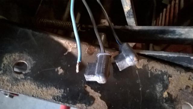

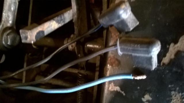

rexman72 210 #1 Posted April 29, 2015 I was checking the wiring throughout the tractor and i came upon Two black wires on the switch that were plugged in and then i blue wire that comes from the solenoid and went to somewhere on the clutch switch.Can anyone confirm where that wire goes to the switch?the end fell off the switch somewhere.The schematic shows on two wires on the switch? Share this post Link to post Share on other sites

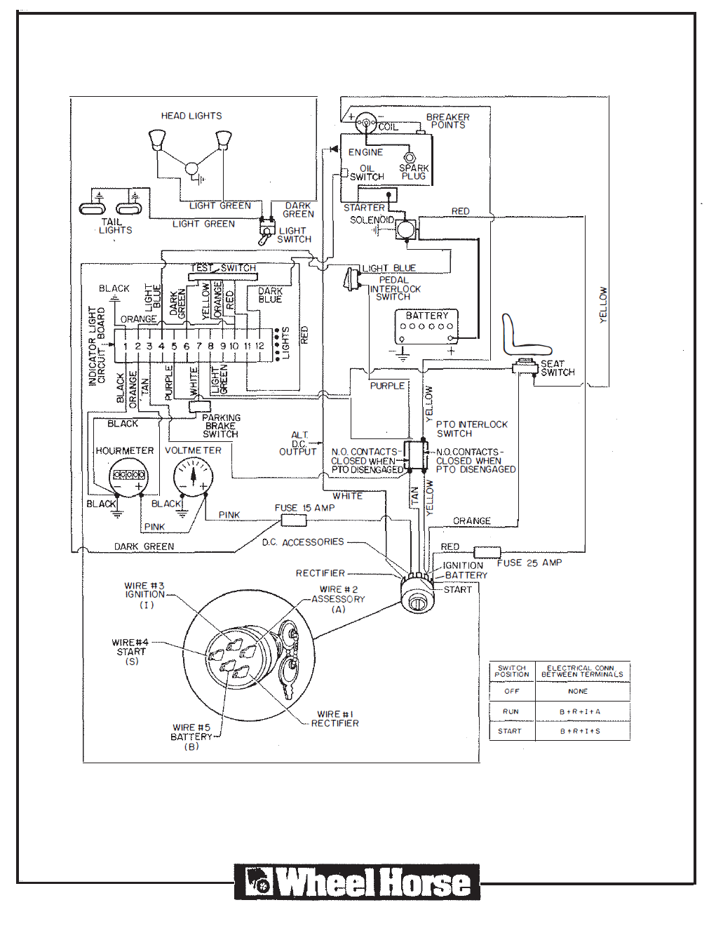

rmaynard 15,770 #5 Posted April 29, 2015 Here's a wiring diagram with color labeling. Share this post Link to post Share on other sites
rexman72 210 #6 Posted April 29, 2015 Ok that shows two wires going to the interlock switch and i have three so i am wondering since the two black wires go to the top two ports that the light blue goes on the side of the switch. Share this post Link to post Share on other sites
gwest_ca-(File Mod) 11,161 #7 Posted April 29, 2015 You best follow those 2 black wires and see where they go. Are the blacks connected together? They may be purple - one to the pto switch and the other to the idiot lights. Only 2 terminals on the switch? purple on one side and the light blue on the other. In the wiring diagram the purples are wired together at the pto switch. Garry Share this post Link to post Share on other sites
rexman72 210 #8 Posted April 29, 2015 the two black wires were on top of the switch and the light blue wire had a angle tip on it and either went on the bottom or side of the switch I assume because theres no othwer place for it to go and the other end goes back to solenoid Share this post Link to post Share on other sites
