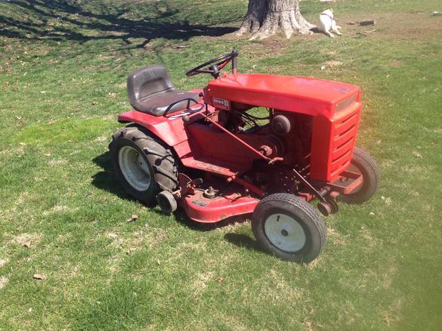

Are these decks designed to ride on the wheels only.I know this doesn't go with  this tractor originally but I made it work by adding the mid lift bar.Tractor has a deck adjusting knob but it seems useless now.And what hole on the lift arm lever should the chain hook to,front hole or rear.any help appriciated.post-14085-0-80963200-1430016436_thumb.j

Yes you can make them work on that model. You may have to extend the lift rod to make it ride on the wheels. If I remember right the lift on that model is just a threaded rod with a bend on the end.  so if its not dropping far enough you need to make the rod longer
