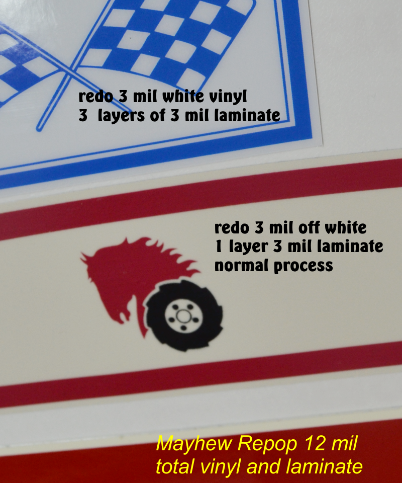

I am basically looking for a set of decals with an extra thick clear overlay on them to give the deep look of the originals.  I picked up few NOS decals (but not enough for a full set) last year and compared to the reproductions there is an obvious difference in overall appearance.  Terry's decals are top notch and the artwork is excellent, but I was explaining what I wanted with the clear laminate and he didn't think his equipment could do that and suggested that I check with Mayhew's because they use a different manufacturing process.  I was really hoping to get in touch with him before I went to the show, I was hoping to have my tractor completed and ready to display.

Vinylguy
I am going to try an idea I have and see if I can get the results. I will do a hood set for the 500 without the racing stripe to save on media in case it does not work. I will post a picture of the actual results when completed..

Vinylguy
Sorry about the poor images. I finished my test and the following picture shows one of Mayhews decals at the bottom. It is a 3mil vinyl which looks screen printed and then a 9 mil thick heavy gloss vinyl laminate
and cut with a die. the decal in the middle is made using a 4 color solvent ink  process on 3 mil digital wrap air escape vinyl and 1 layer of gloss 3 mil laminate for a 6 mil thick decal. the top 500 special hood stand
decal was made the same way but I added 2 more layers of clear gloss 3 mil laminate to make it a total of 12 mil thick. I find the 9 mil laminate on Ed's reproductions still have a deeper finished look due to it being one thick layer as opposed
to three thinner layers? Anyway I am pretty sure the original 500 specials came with white wheels and white background decals. Hopefully someone can chime in that has a clean original to verify. Many of the tractors from the 60s
were exposed to the elements and the white begins to yellow a bit. I am probably wrong but my theory is that if the wheels were white the decals were also and if the wheels were linen beige then they used decals that had a linen beige background to match the wheel color?
