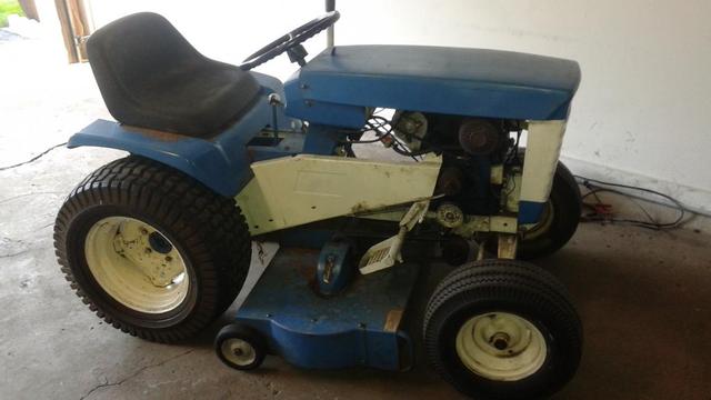

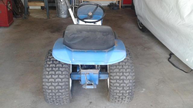

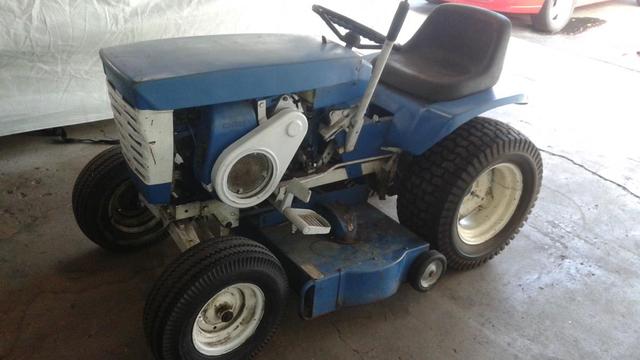

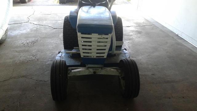

Thank you for your response. I've included a few pictures this time. Looking thru the gallery I was not able to pin down the model. the hood and the deck seem to be square. the battery is under the seat. It does have a pulse pump and the symptoms are: runs fine for a few minutes then have to leave on choke to continue. I guess my main concern right now is to find out the model.

I'm not an expert in these eras, but I can narrow it down to an 855 or 856, assuming the belt guard is still original. They are all pretty much the same tractor from different model years. They will have differences but they will be minor.
The battery should be on a tray behind the engine, but it looks like the tray is missing. The seat has been replaced but all of that's no big deal if he enjoys it!
And other than that... just the wrong color... :teasing-poke:  :law-policeblue:
Looks like its in pretty good shape!
If you can still read the spec and serial number on the engine that will get us the year, also assuming its original.

:WRS: Looks like a great candidate for a restoration. Brandon sounds right on about the model. The tags was likely painted over and hard to see. If you do find it hopefully you will be able to clean it up and see the numbers.

Your deck looks like it may be model RM364,  you will want to keep it well greased.  There are zerks under the caps on the covers on top of the deck for access.

You've got an early model square deck (Prior to mid 1960's)  Another reason my guess would have been a 65 tractor.  By 66, WH was converting over to the more rounded stamped steel decks.
The later style decks may have been more efficient, but those square decks have a serious cool factor.  Nice tractor.  She's dying to shed that blue skin though.
