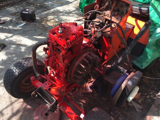

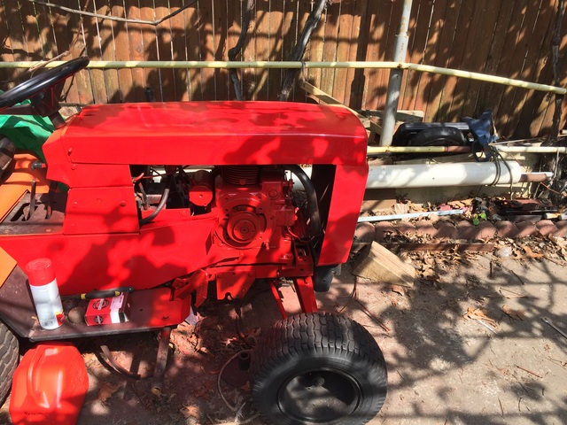

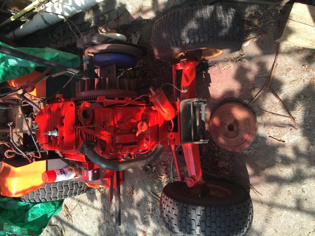

got the motor all mounted had to make brackets out of angle iron will have pics soon

Maybe I'm not seeing this correctly. That looks like a 14hp with the oil pan for a non-wobble mount setup. If that's the case it should be bolted directly to the frame. Before the wobble mounts the 10-16 K's bolted directly to the frame and the 8hp had about a 1" riser plate.
DadsToyMomsHeadache
yes you are correct I mounted it right to the frame but the frame is 7 in across the holes are 71/2 so that's why I had to use angle iron
Racinbob
During that period Wheel Horse used the two left side flange holes bolted to the frame. The two right side holes hung over the frame but there were two threaded holes on the bottom of the oil pan and bolts came up through the frame into them. I'm kinda wondering about your shaft height.
DadsToyMomsHeadache
you are absolutely correct I used the 2 holes on the frame and its hanging off the frame on the other side about 1/2 inch I used the spacers that was on the old cradle mount so the oil cap would clear the frame, Also the height of the shaft is a little higher but does not rub up against any metal that would cause it to fray and break. I also welded the iron to the frame all the way across just because the motor will be under a lot of stress while pulling
