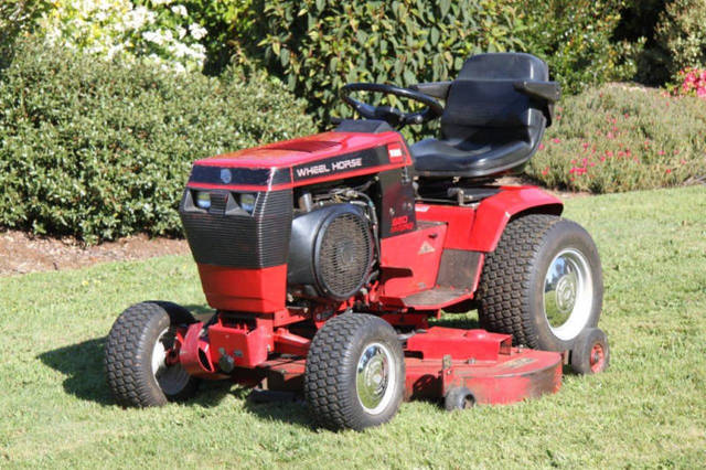

I have amassed a collection of five 520H Wheel Horses along with a 312A, 416-8 and a couple of vertical shaft riding mowers. Three of the 520's are the later swept axle models with the other two being early straight axles.   I purchased the first one about three years ago and paid too much for it, but just had to have one, and they aren't easy to find in Australia - although I have seen quite a few for sale since. My first 520 was in generally good condition, although it had a significant transmission oil leak and the seat was wobbly due in part to a broken tab on the upstand. A 60" deck in good condition came on the tractor.
post-3437-0-39448700-1428662742_thumb.jp
Inspired by some of the restorations on Red Square and my earlier rebuild of my 416-8 I decided to try and refurbish it.  I started by completely dismantling the machine and had  lot of the parts powder coated. I had a short thread in "Transmissions and transaxles" a couple of years ago when I split the transmission and checked the internals as well as replaced the seals. The bearings, gears and differential were all still perfect. The oil leak was found to have been caused by the oil temp sensor probe which had split.
After I got the transmission back together I refitted it to the frame and the project was put aside. I just looked back, and was surprised to see it was two years ago. I did bits and pieces but not a lot of progress was made in between. However, over the past couple of weekends I have been able to make some headway.
Frame assembly commenced.
Transmission nearly ready to refit.
...more to come.
