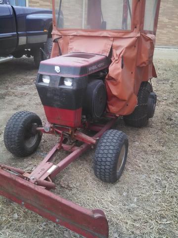

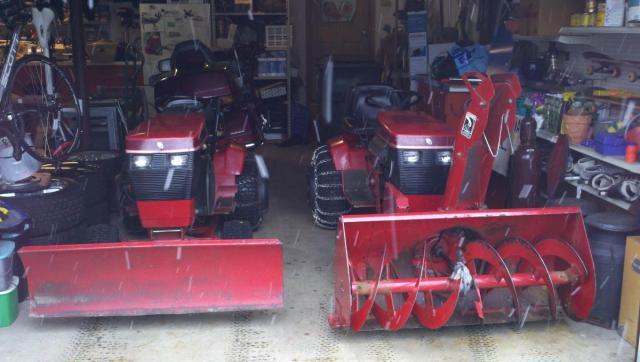

I have been looking for a snow cab.  Seller has one off an 87-310-8.  I want to mount it preferably on my 87-418-A.  Did they make different sizes for different tractors?  Does anyone have a chart to see what they fit?
I have 2 other machines that are similar sizes but I was hoping to dedicate the 418-A to exclusively snow work.  It is an amazing tool.  My son runs it all day and collects close to a $100 per driveway in big storms.  Amazing tool!

Should fit perfectly.  Same hoods and overall shape..

I also have an 88-516-H and an 88-520-H.  So you would guess it would fit any of the 3?
MalMac
It will fit if it's of the newer style with the plastic top. If it has a Fiberglas top it is of the older design and the cab is smaller, it was made for the older C series. It will fit but might need some tweaking here and there.

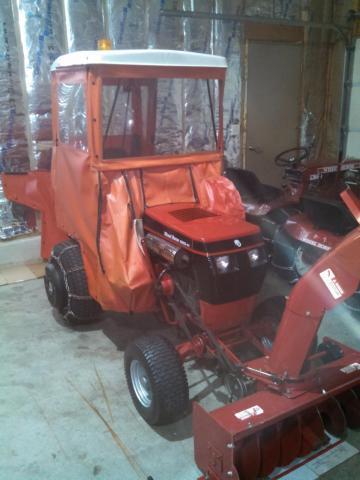

608KEB
This is the cab off my 93 520H. It does have a fiberglass top. I also have a cab off a 95 520H with a plastic top.
