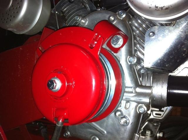

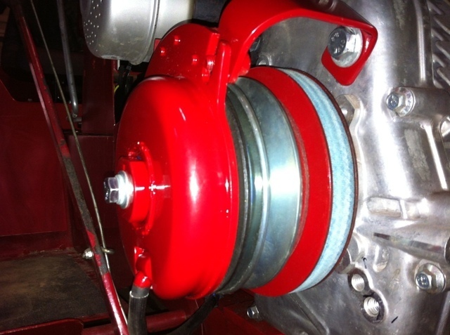

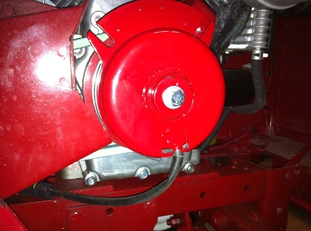

GT14 243 #82 Posted April 27, 2016 Finally installed the PTO 7 1 Share this post Link to post Share on other sites

Aldon 4,828 #84 Posted April 27, 2016 2 hours ago, GT14 said: Finally installed the PTO What make/model PTO did you go with? It looks like a single pulley. True? I am somewhat new to wheel horses but have not yet seen a need for multiple pulleys when there is a dedicated pulley for tranny as well. 1 Share this post Link to post Share on other sites
pfrederi 19,241 #85 Posted April 27, 2016 Two PTO pulley sheaves are for different implements.small for power larger for more speed (mower decks) smaller for more power (snow blowers) 3 Share this post Link to post Share on other sites
GT14 243 #86 Posted April 27, 2016 There is only one large pulley 5 3/8" DB Electrical PTO0003 Electric Pto Clutch 2 Share this post Link to post Share on other sites
