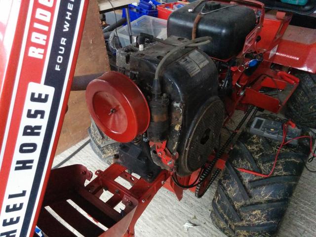

*update
The engine has done two hours, so barely run in and it's got a very pronounced knock :(
My assumption that it would be fit for purpose was wrong - it didn't actually knock before, but had poor compression and oil everywhere!
So before I break it, it has been removed for another rebuild - we crank pin re-grind to 0.010 or possibly 0.020 depending on the damage :(
in it's place is a k341 from my C-161, shame it's not a straight swap. The starter motor is lower and clashes with the battery tray. The throttle/choke mounts are different and I've no +12V to the coil because the magnum uses a wire to kill the spark...
