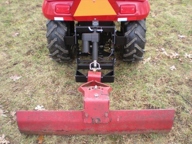

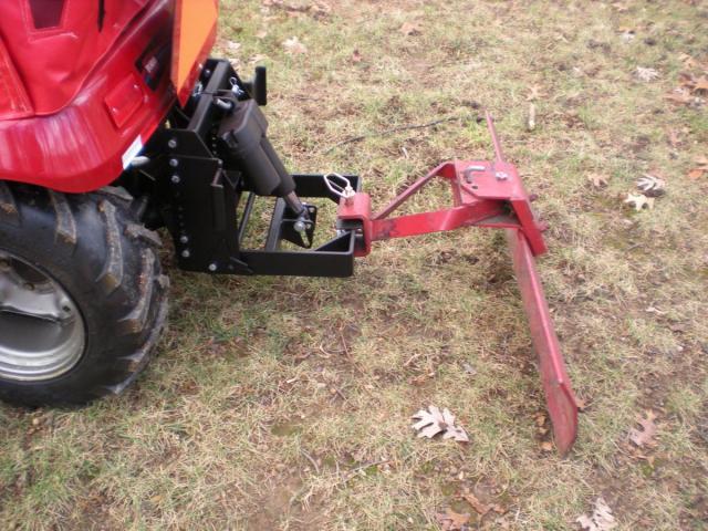

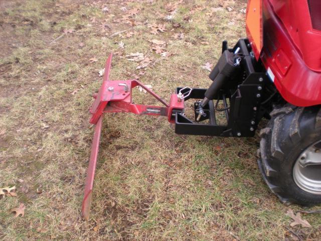

wh500special 2,244 #10 Posted March 25, 2015 I think we're answering the question a little differently from what the op is asking. I assume he's asking about the differences in the two mid mount blades: the older 40" pull type that mounts in the mower deck hitch, and the newer 50" push type that mounts to the same rear axle mount as the snowplow and tiller. In my opinion, the larger 50" pusher type is better suited to the large 520 tractor. They are heavier and are heavier duty as well. Easy to mount, can be angled from the seat (sort of) and ought to cover the full tractor width when angled. Front mount snow blades aren't good for leveling. If you have loose material and drop the blade then drive in reverse they do a fair job. But I think they're a bit limited in what they can do for grading and grooming. Steve 1 Share this post Link to post Share on other sites
Red-Bovine 324 #11 Posted March 25, 2015 In 1994, when we built our second house, I used our 520H with the 50" mid mount blade to finish grade our yard. It mounted with two quick release gizmos on the rear axle and a push/pull bracket on the lift mechanism. I did a lot of gravel and soil moving with that rig. We had huge piles of top soil (soil was stripped from building site and sat for over a year) to move around that we were able to level by skimming off the top and sides of the piles and spreading it around. It took a few days to get all our finished grading done, but saved us $5000.00 over what a landscaper wanted to do. He wanted to do all the work with a D9 and we would have lost several trees in the process only because his D9 couldn't get around them. We also used it to keep the gravel drive smooth and spread new gravel and TB until it was paved. Really a great set up. After years of not using it, we sold it to Cheesegrader. Red 1 Share this post Link to post Share on other sites

Forest Road 594 #19 Posted March 26, 2015 I have a 50" mid mount grader blade. Our vacation home has approx 1/4 of gravel driveway. Which on occasion has needed some maintenance. This blade has been indispensable! By far my favorite attachment. It attaches at the rear axle with the snow plow hitch. I've tried tow behind York rakes, "driveway groomer" and WH snow plow. NOTHING has given me the clean results of the 50" grader. Expect to pay $200-450. Sent from my iPhone using Tapatalk Share this post Link to post Share on other sites
