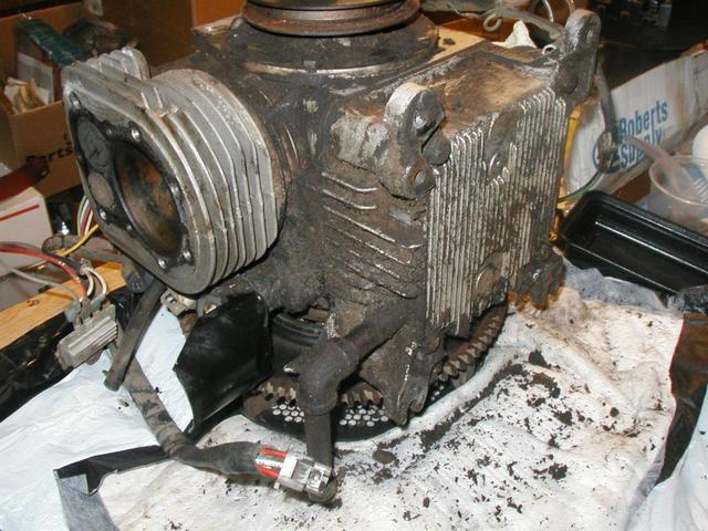

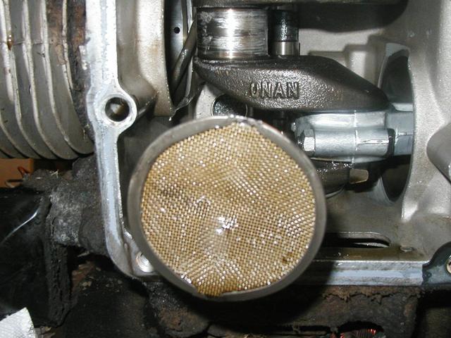

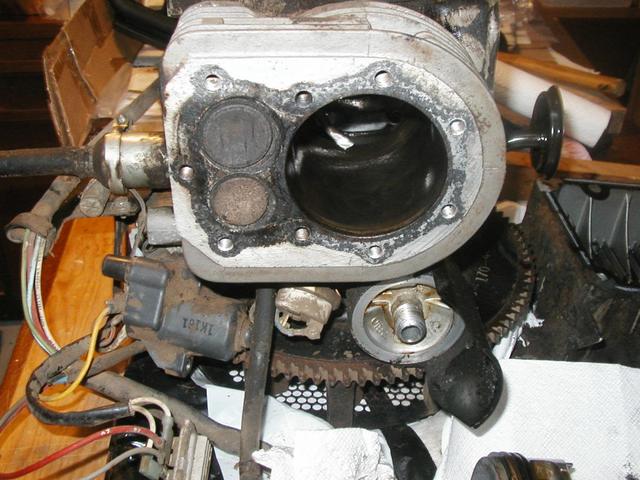

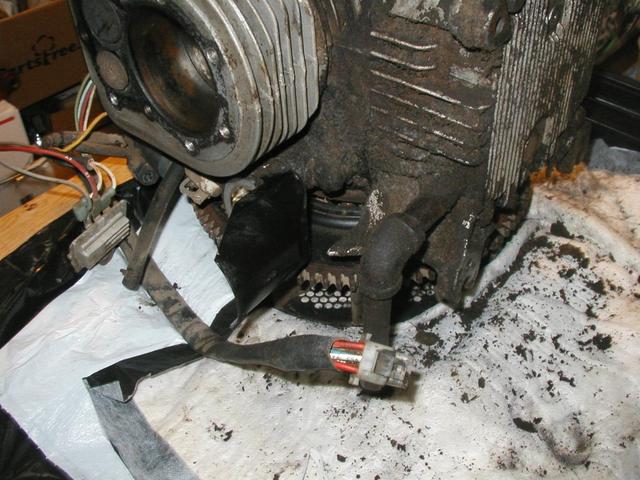

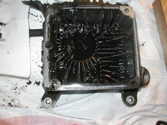

I bought a 1990 416H with a bad ONAN engine a few years ago.  I paid what the deck was worth for the whole thing including a new red vinyl wheel horse tractor cover. I finally got around to opening the engine to see what went wrong.  The engine had about 1000 hours on it and the tractor was used primarily for mowing.
The first thing I noticed was the extreme amount of grime around the cooling fins on the back and bottom of the engine.  Clearly the engine overheated and the rod disintegrated. The cylinder wall was fine and the piston was still a snug fit in the cylinder.  There was carbon but not enough to be the cause of the failure.  I did not check the valve clearance on the back cylinder since it was clear the grime prevented the engine from cooling properly.  The valves and valve seats looked fine.  After seeing this I will be taking my ONANS off the tractors and giving them a thorough cleaning along with the de-carbon and valve clearance checks at least every 500 hours or so.  This may be one of the main causes of the rear cylinder failures on our horses.  The pictures of the engine are after a removed a significant amount of grime.  Not sure what i will do with it but I did purchase a new rod and piston and new valves.  Not sure how bad the crank is.  The oil tube got destroyed also.  If these engines are neglected and not allowed to cool properly they will be toast. Periodically cleaning the cooling fins on the entire engine is a must do. The way these engines are mounted in our tractors, it is way too easy to neglect the bottom and rear of the engine and it is not just grass accumulation.  An oil temperature gauge may help provide a warning sign.

  Yup, Also when low on oil the last thing in the chain is the number two rod and cylinder. Heat+low oil = failure. Judging by the aluminum caked on the crank , it would appear the rod seized on the crank and the rest is self explanitory. The neat thing about onan motors is they rarely damage the cylinder when that failure occurs. One of mine , the wrist pin seized also which scored up the cylinder requiring a rebore of the cylinder. Most of the time the aluminum will clean right off and mine have measured with in spec but some of the cranks I have seen where chipped from shrapnel and ruined the crank.
  Hopefully you cleaned up and measured the crank before ordering parts. Looks like its savable though!

Looks like an oil change or 2 wouldn't have hurt one bit

Something to consider is drilling holes will only cause more dirt to easily find its way in there. The build up is usually from an oil leak like oil filter base gasket, crank plate, or Welch plug over cam. The oil then soaks the motor and attracts dust. Fix oil leaks, degrease engine, then blow down the motor regularly.

Roundhouse hit it on the head. I have scene same scenario Oil Filter base gasket is usually the first culprit or dipstick tube lower seal fix them clean it blow it out your good to go
