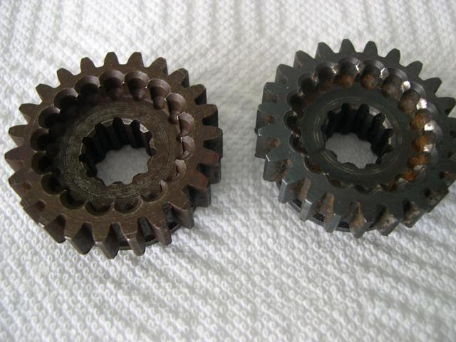

The third gear issue is going to be the hook up between the 3523 Hi/2nd gear and 3522 input gear. here's a picture of a worn 3523 and a NOS. I would suggest starting by watching the videos here. A good inspection of everything and some pictures and you'll find all the help you'll need right here. It's really pretty straight forward once you get into it. For sure replace all the seals. :)
I was typing when Jake posted. He's spot on.post-8408-0-40677400-1426596204_thumb.jp

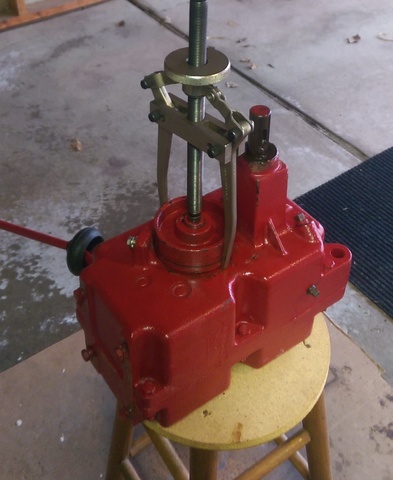

Well, here is the only picture I have right now, but I will definitely take more once I get it opened up.

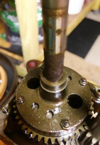

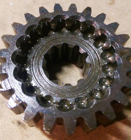

So I finally got the brake drum off and the case opened up. As suspected, the 3523 Hi/2nd gear is worn. Anybody have one they are willing to part with? Also, I noticed some rust on the axle starting at the differential case, extending about 2". Is that common and/or something to be concerned with?
I was a little short on time tonight, so I went right for what I thought was the issue. Hopefully I can inspect everything else tomorrow night.

Yup, I'd say that 3523 gear is a paperweight. Total toast. Hows the 3522 input gear/shaft? That rust on the axle baffles me. Was it full of water? In my opinion the best thing to do is get everything inspected and post more pictures. You'll be getting help on the parts.

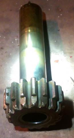

Here is a picture of the 3522 input gear. I drained, flushed with diesel and refilled last fall and did not notice any water. I can only speak for the last 20 years or so, but it has always been stored inside. What's strange to me is that the rust is isolated to that one location.

I'm thinking that input gear will be OK but again, not that 3523 gear. I'm a little late in asking this but did you have any in/out play in the input shaft? I did on mine. It was a 5010 transmission but for what we're dealing with here they are the same. When I would put it in 3rd I could push the shifter past the detent stop. Of course it would pop back to the detent but that disengaged the gears close to 1/8" and allowed the in/out play. I solved the issue by using an arbor shim on the input shaft behind the gear. I'm really not certain that was the correct fix and was tempted to open it up again but it is complete and painted and working fine so I decided to leave it as is. I believe your input shaft along with the 3523 gear on the right in my picture will work for you depending on how hard you plan on working this tractor. The NOS gear on the left is in my tranny now. Steve will be along shortly so let's see what he thinks.

The rust is a non-issue.  Just wire wheel it clean and put a little Lucas Oil on it.  Input shaft looks like it is OK...need the 2nd/3rd fork gear though.  Send a PM to "Racinfool40" first.  Jake Kuhn may have one...after that we really have to ask around.  :)  Mentone swap is coming up in a few weeks...I can keep an eye open for you if we do not find on by then.  :)
