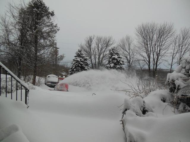

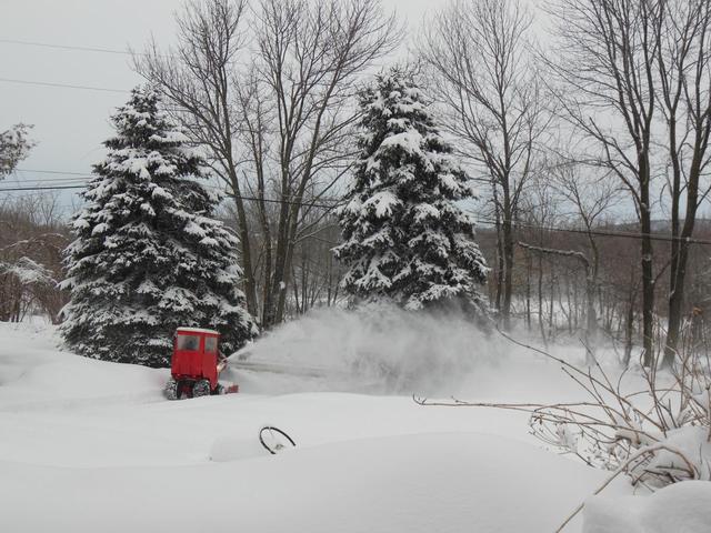

I don't know Eric and Ed. My tall chute is slinging the snow just fine with the little 16hp onan. It only clogged once all year long and I was blowing snow that was like water a few times this year. The reason it clogged was I had a mouth full of road slush and the pto popped out under load on me. I didn't have it tight enough. Cant blame the blower. I run on the inner pulley around 3000 rpm and spray the inside with Teflon chain lube. Works out ok for me.

I was just poking a little fun. My buddy has a 520h with a two stage and it clogged this last snow. I laughed and told him, don't worry I won't tell anyone. Lol I really like running my tall chute. One of the best tools I have for the house/ horse. That stuff really froze to the metal though. Had to chisel it out with a broom stick. But once I got it out, I sprayed the chute and auger down, and went right back to the same slush. Only this time, the pto was a few turns tighter and it ate right through like a knife through butter !
