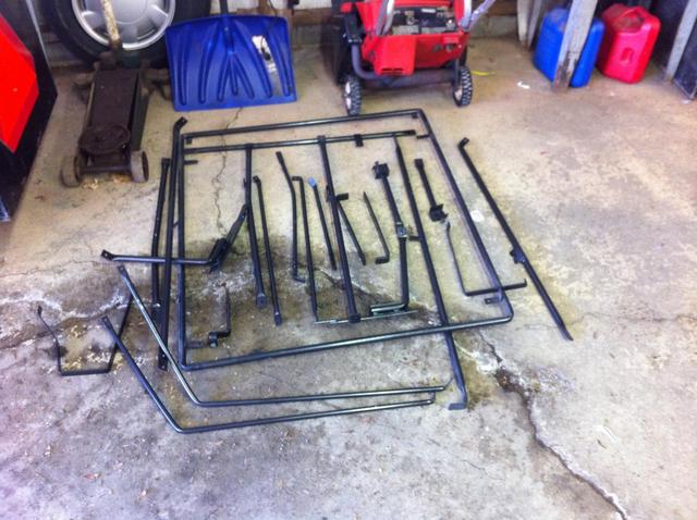

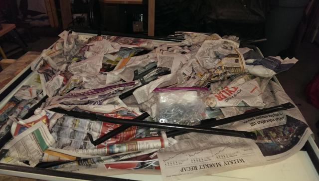

squonk 41,942 #10 Posted March 8, 2015 (edited) Guy is delivering the cab on Thursday. He took it all apart when he stored it away 6 yrs. ago. Every thing was cleaned, Frame painted, vinyl was treated, all new nuts and bolts and stored in a bag. He said it doesn't say Wheel Horse on it. But it's red and white and was made to fit the 300-500 series tractors Edited March 8, 2015 by squonk Share this post Link to post Share on other sites

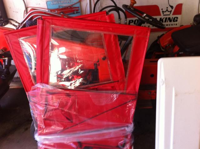

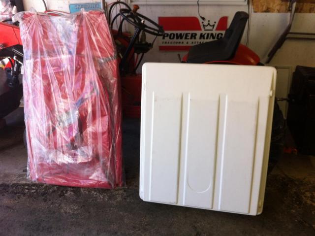

squonk 41,942 #21 Posted March 12, 2015 (edited) Cab was delivered today. Looks pretty nice. An interesting summer project getting this varmint fitted to the C-160 to say the least! Sorry about the Power King Sign! Edited March 12, 2015 by squonk 2 Share this post Link to post Share on other sites

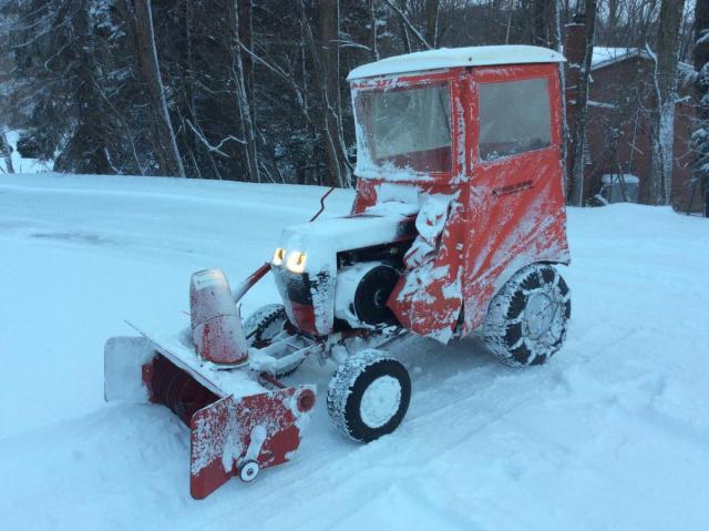

312Hydro 474 #22 Posted March 13, 2015 Here's the reverse. A cab for a C series on my 520h. 1 Share this post Link to post Share on other sites
squonk 41,942 #23 Posted March 13, 2015 (edited) Is there a tractor under all that snow? Edited March 13, 2015 by squonk 1 Share this post Link to post Share on other sites
312Hydro 474 #24 Posted March 13, 2015 That was taken after a recent snow with the "light ,fluffy stuff" and a wind. I did get the cab to fit without any alterations but It would be better if I could get the rear panel "bumped out" to give more room. The adjustable seat is moved forward and I'm up against the wheel more than I'd like. I am going to make a mounting that goes under the seat like factory. The present mounting uses 2 tabs that bolt to holes in the rear of the fender pan and I don' t want to drill those. Share this post Link to post Share on other sites
