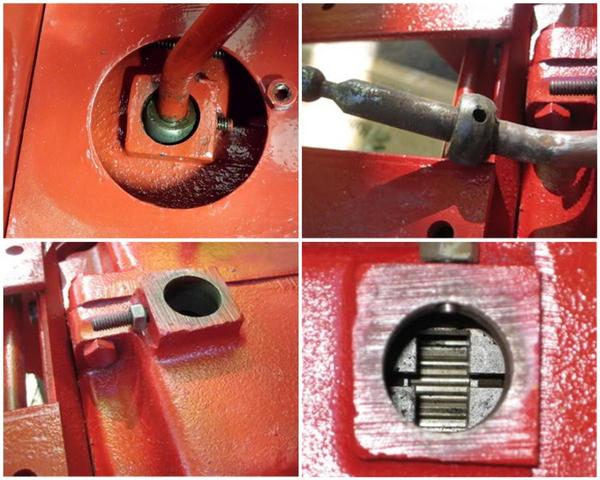

Before you tear it all apart, pop off the SHIFT PLATE and have a look at the shift lever.
If it flops around freely, the end of it MAY be broken off, or it MAY have come loose from its pivoit point, being the DOG POINT SCREW. Can you lift the lever up out of the trans? If so, then it MAY not be the shift forks but something simpler, like a broken DOG POINT. Here are a few pics to help:

Thanks, I didn't realize the shift lever came out without splitting the case. If the end is broken off, can the ball end be removed and another shifter installed? I will go have a look.

YES, it lifts right out of the trans. The shift lever is in good condition, looks fine. But it lifted out without having to remove/loosen the retaining bolt.

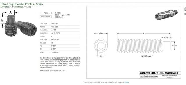

THen your dog point set screw is broken or missing.  Hopefully the dog point end didn't fall into the tranny.  Toro has them and so do good hardware stores.  (1/4 20tpi) You also need a nut to use as a jam nut .Thread it in by hand until it seats in the small hole on the gearshift lever donut.  The back off a 1/8 turn and tighten the jam nut.

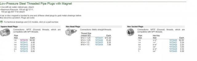

Yes make sure the forks are aligned for neutral as in picture above.  Ball on end of shifter should be round not worn flat on the sides.  Hopefully screw just backed out a bit and lost contact with shifter.  If you think part fell inside drain tranny and flush with diesel. Raise front of tractor so fluid and junk clear th bump in the middle of the tranny case.  also consider a magnetic drain plug

Most likely Texis as long as your shifter is OK. That 'donut' where the setscrew runs in to is either welded in place or has a roll pin. Align the forks so they look like the bottom right picture Dave posted. That's the neutral position. Make sure the setscrew runs in to the little hole on the donut. Adjust as Dave said and you should be good to go. This is a common problem on Wheel Horses but a simple fix. :WRS:

I think the real problem you had was that the set screw backed out and cause the problem (happened to me the first time in a snow storm).  Get a new dog point set screw and a jam nut.  Put some blue loctite on both of them and reassemble.  Do not screw the set screw in so tight that the shifter will not move (or only moves with difficulty).  If this happens, back off the set screw by 1/4 turn and tighten the jam nut.
