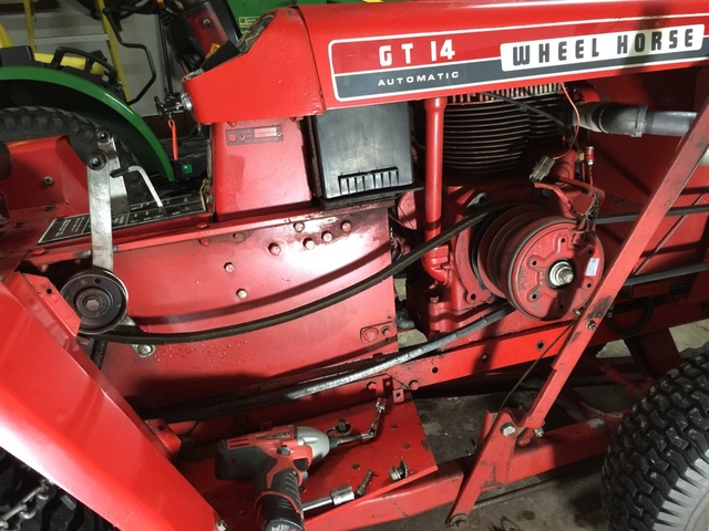

Hi all. Been plow in' snow and i gotta say this thing pushes snow better than it should. Noticed when drive was engaged was hearing a bit to much noise. Pulled side cover and belts got a lot of cracks so I'm going to change it Two questions
It would appear I can do this without much more than the main cover off ? & the electric clutch brace removed?
Is there a size for this belt anywhere here on this site. I have all original manuals but figure this is just obsolete data .(unless you have a cross reference chart )

The belt number listed in the manual should be correct. I highly recommend Wheel Horse belts for the drive train. They are cut at a particular angle to maximize belt to pulley fit.
The belt cover and PTO mount need to be removed to put a new drive belt on, as you suspected.
Make sure belt is routed correctly inside the belt guard.

You need a belt designed to withstand the reverse bending over a flat idler pulley.
The more common fractional horse power (Fhp) belts are for use on low horse power electric motors but use the same numbering system and will not last.
The Wheel Horse/Toro belt is # 8334 - Size B x 84.8"
The green Gates # 6985 belt is a suitable replacement - Size 5/8" x 85"
The same green Gates belt made for Napa # 5L850W - Size 5/8" x 85"

OEM - 8334, tiller - 9151 I have used both of these belts with No problems!!!!

 Thanks this is what im looking for. And if I had a toro dealer nearby I'd just call them up or stop by on way home from work.This is not the case.  For all those who suggested OEM I'm in total agreement .I have done belt replacement in the past by doing this cross reference method with mixed results. I  now know why.Thanks to ALL here for the info.Going to check out All my belt options $$$

Every parts list I see shows the 8334 belt 1969-1973. Left over 1972 models were sold with a 1-0502-8 model number.
Item # 302 on page 8 of this manual shows the 8334.
Drop the 8334 number here you can see it is still good at Toro
http://www.rcpw.com/search/?quest=8334
