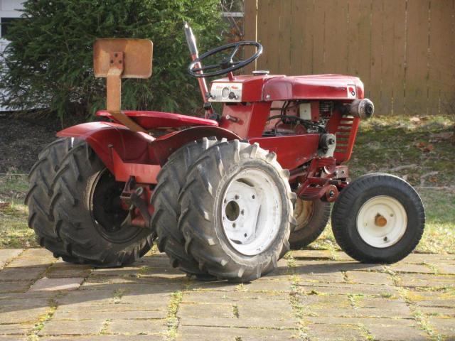

I know some of you have added duallys to your tractors... My question is how did you do it? Id like to add them to my 312-8 for looks. Thanks!
scotty
Theres a guy on ebay i believe hes a member here and he sells the dual wheel adaptor kits.
Spacers between the wheels will allow you
post-3498-0-80656000-1343410389_thumb.jp
post-3498-0-15498400-1342473780_thumb.jp
you join two sets of 'em together.

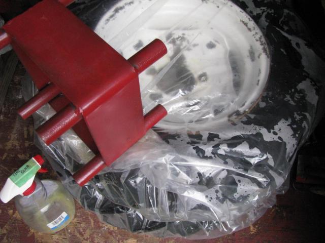

can whlvr
heres a pic of the adapter I welded,some gas pipe and flat steel

Be careful that is a WHOLE lot of rubber hanging off each side.
The amount of friction when you are turning on a solid surface from the two same side tires working against each other or being on un-level ground is probably enough to worry about axle breaking...
Not to mention the serious torture that you will be putting your diff and bearings through.
