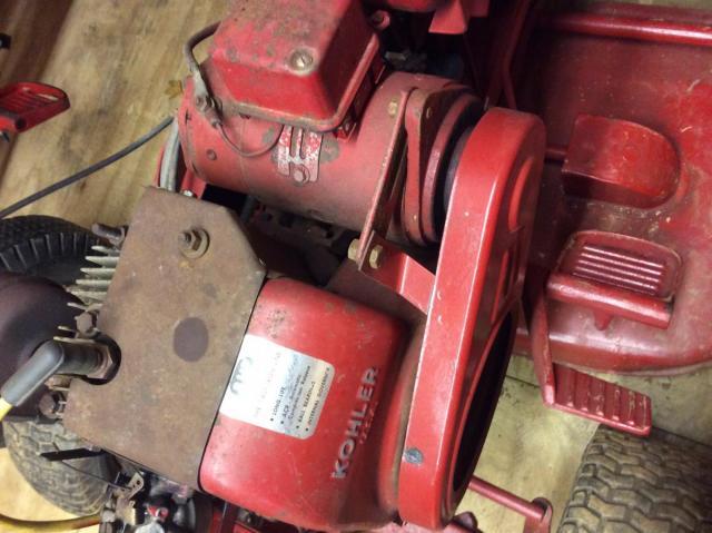

Was wandering if anyone had dimensions of the support bar that belongs here? Or I would be interested also if someone has a spare lying around. Should be easy to make too. Thanks for the help. It's on a 876, enjoy the homemade top engine shroud previous owner fabricated...post-14030-0-19381100-1421602820_thumb.j

It looks to be an overall length of 9"L 1" W a58cba46d1e3f0ed166c394b85f471fa.jpg4c940335ff2ef1ff52b726429e420f37.jpg
If you don't mind waiting a couple days I can make you one for about 10$
Live4outdoors
Slammer thanks for the reply and pics, how thick is that piece, I thought it would've been the same as the slotted bar the starter bolts to for adjustment but that looks really thick in your picture...thanks
slammer302
3/16"
