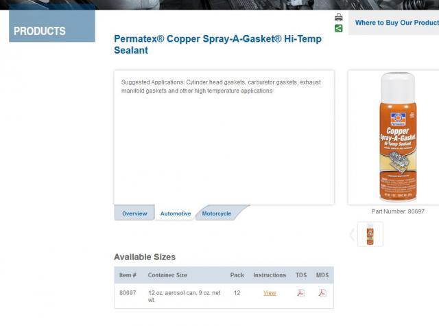

doc724 927 #10 Posted January 7, 2015 Stevasaurus, What is this copper coat? I am not familiar with it and where do you get it? Share this post Link to post Share on other sites
pfrederi 21,145 #11 Posted January 7, 2015 Stevasaurus, What is this copper coat? I am not familiar with it and where do you get it? Permatex Copper-Spray -A-Gasket Item 80697 at any autoparts store Originaly designed I believe mostly for head gaskets. http://www.permatex.com/products-2/product-categories/gasketing/gasket-sealants/permatex-copper-spray-a-gasket-hi-temp-sealant-detail Share this post Link to post Share on other sites
stevasaurus 23,845 #12 Posted January 7, 2015 Correct Paul. I think I bought my last can at Auto Zone. I don't know if I would use it for head gaskets, but in the old days, when gas stations worked on cars, we would use it on rocker cover gaskets, water pump gaskets, thermostat gaskets, side cover gaskets, It looks like it actually has particles of copper in it and is very sticky. It also comes in a can with an applicator. Very good stuff. Share this post Link to post Share on other sites
pfrederi 21,145 #13 Posted January 8, 2015 Correct Paul. I think I bought my last can at Auto Zone. I don't know if I would use it for head gaskets, but in the old days, when gas stations worked on cars, we would use it on rocker cover gaskets, water pump gaskets, thermostat gaskets, side cover gaskets, It looks like it actually has particles of copper in it and is very sticky. It also comes in a can with an applicator. Very good stuff. I have used it on a couple of old tractor head gaskets (water cooled). Never did it on Kohlers as I never had a sealing problem with them, and the head may get hotter on an air cooled engine. 1 Share this post Link to post Share on other sites
