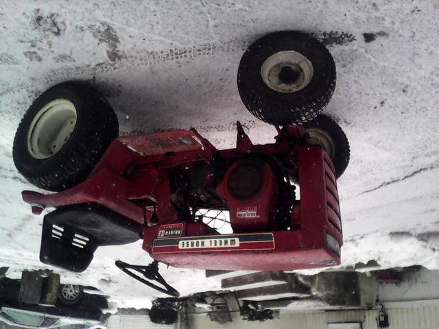

WHEEL HORSE 312-8 52 #9 Posted January 30, 2015 Picked this up few days ago it has the that ignition thankfully it works 1 Share this post Link to post Share on other sites
