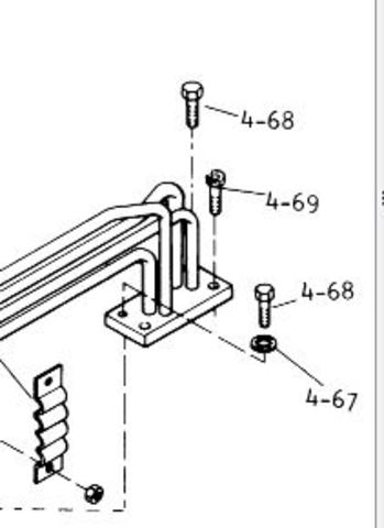

pfrederi 21,083 #2 Posted December 26, 2014 Did you look at the "special" washer?? 4-67? I have used copper crush washers and more recently steel and rubber sealing washers from Mc Master. I can send you one if you need it. Share this post Link to post Share on other sites
Hodge71 691 #3 Posted December 26, 2014 (edited) I have them Paul. I have a local hydraulic guy that can build me the o-ring kit that toro sells for $22, he builds for 4.50+tax. The "special" washers included. The leak isn't coming from the manifold. It appears to be between the case and motor but only at the top by the manifold. It's too difficult to tell where and my arm isn't cooperating much today so I doubt I'll be getting the wheel off for a better perspective. Sent from my iPhone using Tapatalk Edited December 26, 2014 by Hodge71 Share this post Link to post Share on other sites
