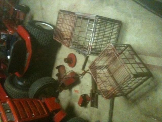

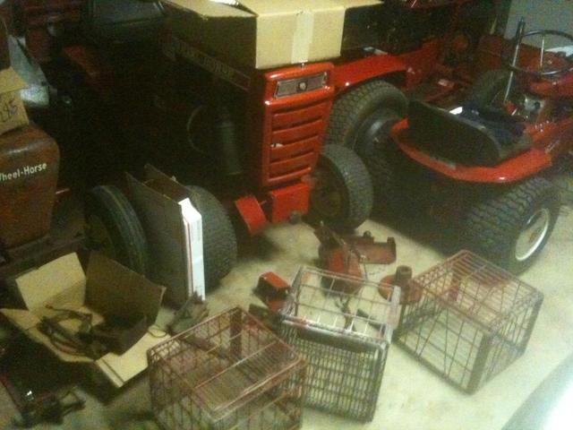

Shynon 7,475 #1 Posted December 25, 2014 After wrestling a few transmissions I decided there has got to be a better way instead of trying to balance on wooden blocks. So here it is, just a standard wire milk crate, cut out a few of the wires and the trans sits in it stable and easy to work on. Thanks for looking. 9 Share this post Link to post Share on other sites

Lane Ranger 11,122 #4 Posted December 25, 2014 (edited) Shynon: Great idea. I have three of those old metal milk crates from Dixie Dairy in Gary, Indiana that I use constantly for support of a lot of Wheel Horse projects! I have had them for 30 years. I love them ! Edited December 25, 2014 by Lane Ranger 1 Share this post Link to post Share on other sites
WH 312-8 Fan 9 #5 Posted July 12, 2015 now there's an idea. I was wondering the same thing myself. I have a round hole cut into my side workbench for a trashcan underneath. I braced it with 2x4's across the hole for the axle carrier. I like your idea much better with the milk crate. Share this post Link to post Share on other sites
