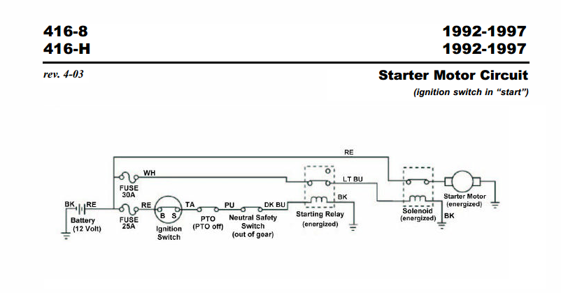

Hello gentleman,
Problem: will not crank on its own, will crank with jump box—but still not fire
Recent things I did prior to this issue: cleaned fuel filter, replaced battery cables, replaced cable from ignition to starter
I have my test light out and am probing around.
There is no power at ignition/magneto wire or the ignition/starter wire
There is power everywhere else

Detailed wiring from the Demystification Guide #492-4509
4 pages 1.4MB Color
p7-67 to p7-70
Onan powered
1989 416-8 model 31-16O801
