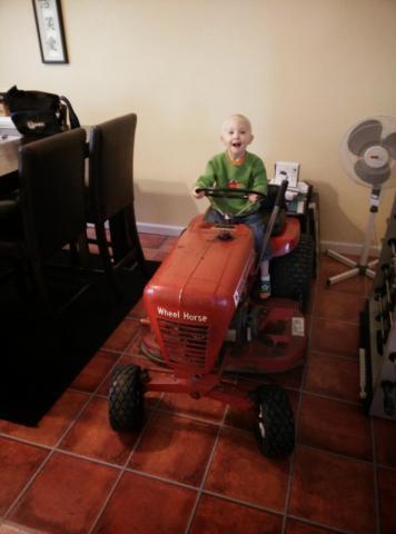

:text-+1: They double as new toys for the kids in the winter. :ROTF:

Awesome AJ!  Can he drive it around the house?  :laughing-rolling:
