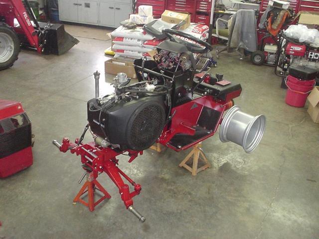

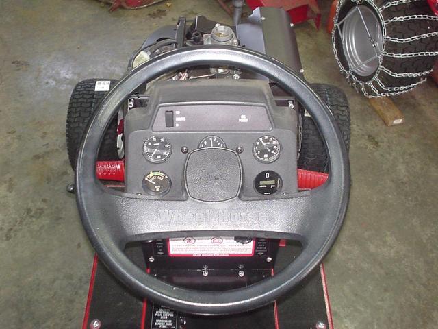

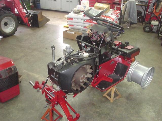

My latest horse. A 520-HC
cleat
I prime before the gloss paints, IH red, silver wheel, and black.
I do not prime before applying the high temp semi gloss paint or the cold galvanizing.
All paint work shown is spray cans. Hood and fender will get sprayed by my neighbor who also paints cars on the side.
Everything but the IH red is Rustoleum. IH red is Rust check brand from Canadian tire. Seems to go on fine and drys quickly.
Cleat
Forest Road
Cleat

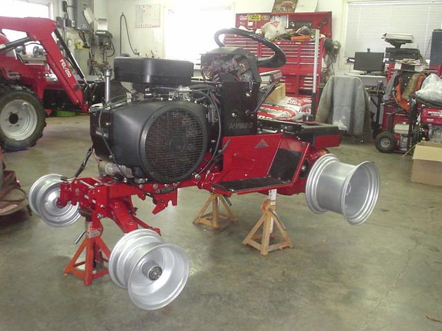

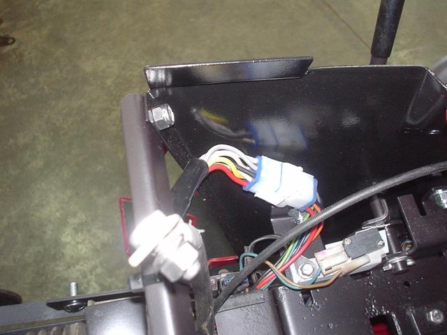

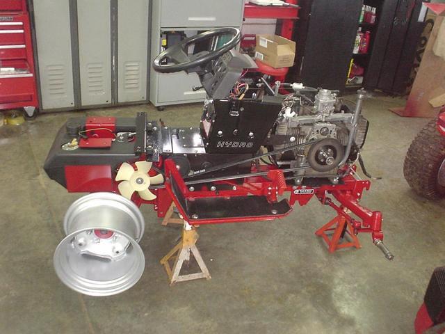

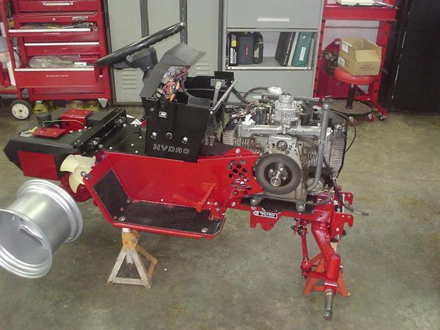

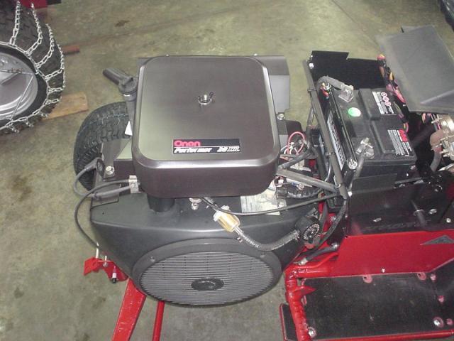

New sealed 9 pin connector installed. Engine then installed and connected. Waiting on the Welch plug for the cam to arrive and then exhaust and PTO can be assembled.
New plugs and wires installed.
post-11822-0-77164800-1423237972_thumb.j
post-11822-0-22047300-1423237994_thumb.j
post-11822-0-26885000-1423238008_thumb.j
post-11822-0-12835000-1423238021_thumb.j
post-11822-0-60057800-1423238031_thumb.j

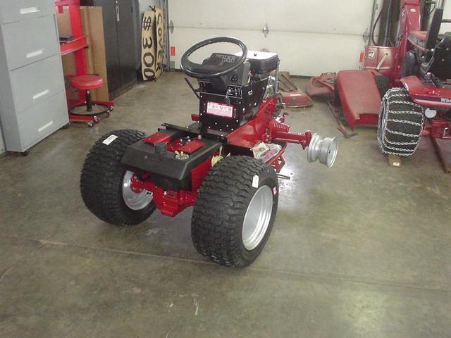

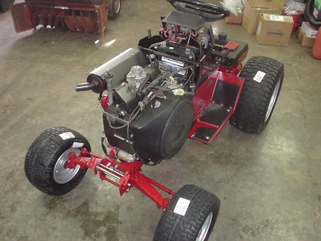

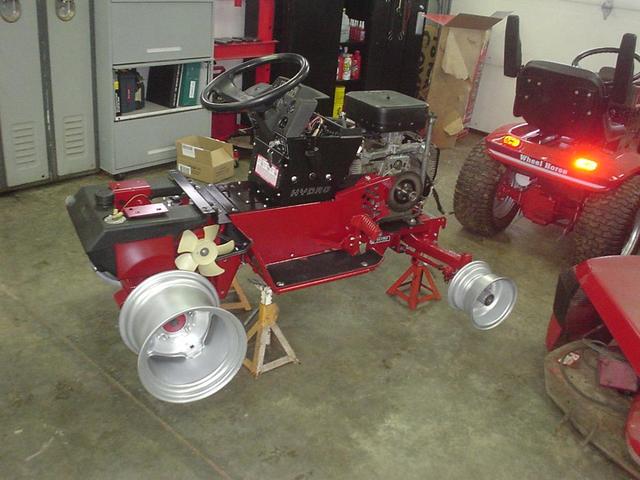

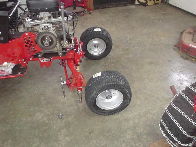

Pressed new bearing races into front wheels then mounted wheels temporarily with the new bearings until the tires come in.
post-11822-0-92964200-1423405751_thumb.j
post-11822-0-99891200-1423405765_thumb.j

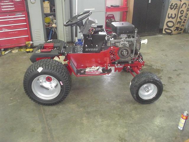

New tires mounted. Rear wheels bolted on. Front wheels bearings greased and installed.
post-11822-0-13855900-1424970744_thumb.j
post-11822-0-48961400-1424970764_thumb.j
post-11822-0-24125200-1424970784_thumb.j
Cleat
Ken B
Man that is lookin sharp!

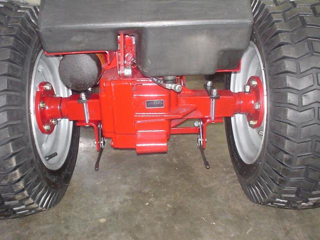

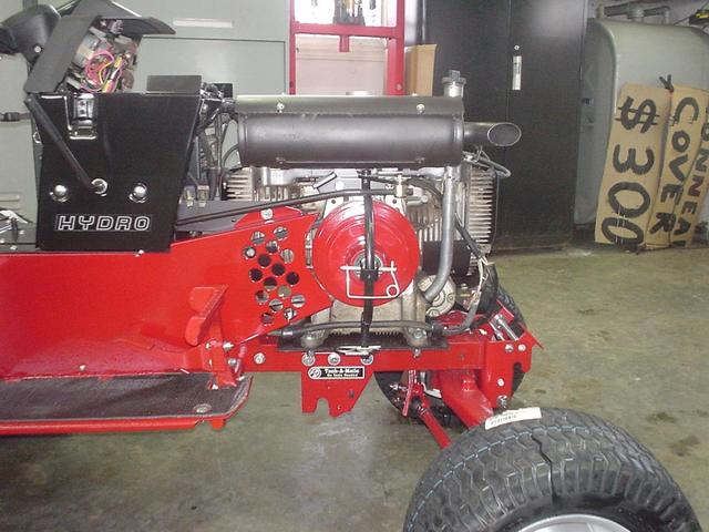

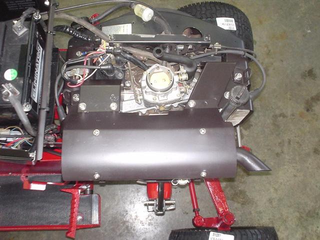

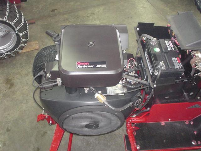

PTO all hooked up.
Rear lift assembly installed.
Muffler and heat shields installed.
Welch plug for camshaft replaced.
Proper dash installed.
New battery tray installed then installed battery.
post-11822-0-31940200-1424986135_thumb.j
post-11822-0-02517200-1424986149_thumb.j
post-11822-0-51099800-1424986162_thumb.j
post-11822-0-82350600-1424986175_thumb.j
post-11822-0-19616200-1424986188_thumb.j

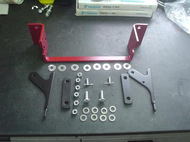

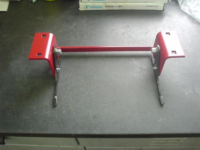

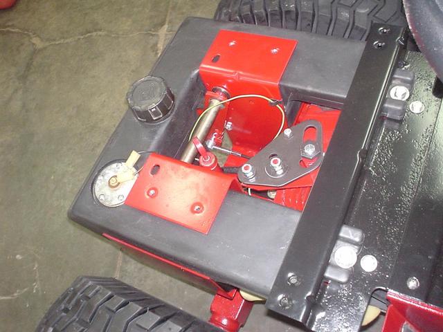

Air cleaner bead blasted, painted and installed. Decal applied (thanks Terry, this looks great).
Rear hitch bead blasted, painted, and assembled (thanks Al).
post-11822-0-08530900-1425306552_thumb.j
post-11822-0-71405200-1425306565_thumb.j
post-11822-0-61490300-1425306577_thumb.j
post-11822-0-66608100-1425329466_thumb.j

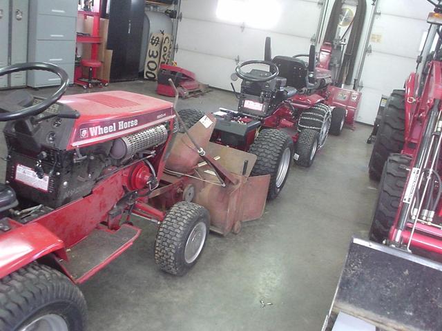

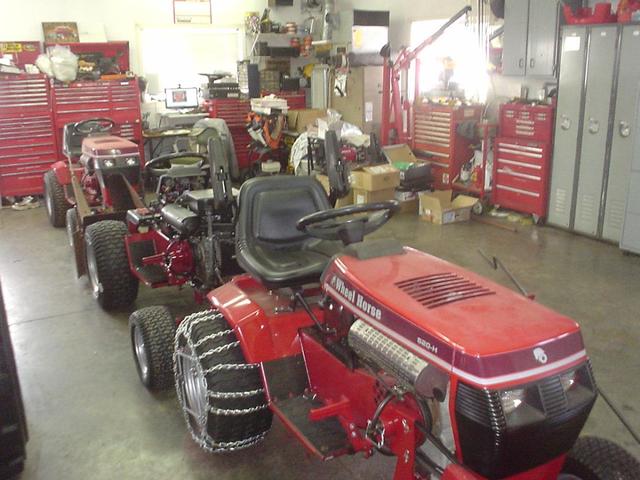

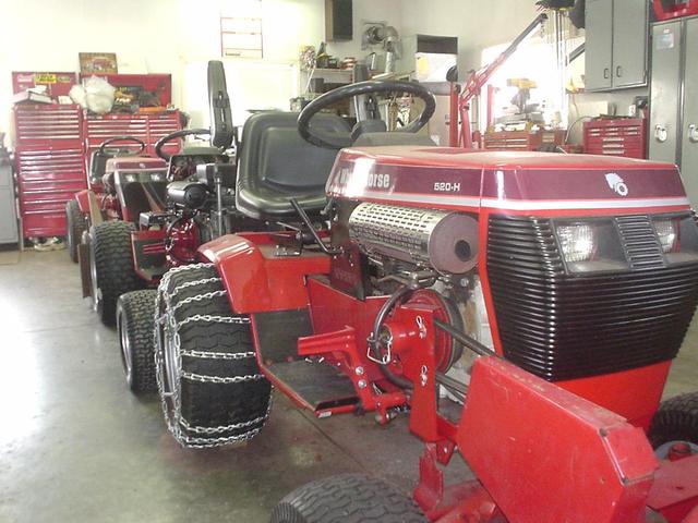

Just for fun I lined up the wheel horses.
The front 520-H is complete, the center one is my 520-HC in progress, and the rear one is my 520-H that will be getting torn down and converted to be just like the front 520-H which is a 1988 model.
post-11822-0-14925600-1425330911_thumb.j
post-11822-0-68592500-1425330923_thumb.j
post-11822-0-36547700-1425330937_thumb.j
Cleat
woodchuckfarmer
The old snow blower looks pretty dingy next to all that nice red paint . Great looking tractors Cleat......Wayne
