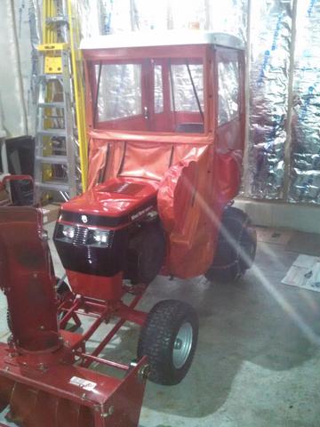

Do you think I could run this (intermittently perhaps) in my 314-8?

Craigbic. Your 314 should power it. Don't expect any real heat for the cab. It will however keep an area clear on the windshield so that you can see. If you have a wiper you'll want to use it as there's not a lot of melting taking place except where you aim the defroster. I had mine mounted with velcro to the lower left corner of the windshield aimed in the area that I needed to look through. I only ran it when absolutely necessary to reduce the drain on my battery.
I just look at the picture of your cab. I don't know how well this will work on a vinyl window. Since it doesn't put out a lot of heat I wouldn't worry too much about it melting the plastic I just don't know how good it will do in melting any snow on the outside along with any fogging on the inside.

craigbic
I was thinking more about all the fogging I get on the inside windshield when I'm in it for awhile.

craigbic
I was surprised how compact the 314-8 control area is in general and then you add a confining snow cab and a big guy into the mix and I'm huffing and puffing just getting into it!  :grin: I also found myself leaning into the windshield a bit and had to consciously sit back. The HF heater is dirt cheap so I guess the worst that can happen is my battery cuts out snow blowing and I'm out $15.

craigbic
It's funny, the engine and/or my respiration seem to keep my cab warm because for the few hours I've used it snow blowing, I had to take my sweatshirt off because it was too warm in there. I just want something to keep my vinyl window fog-free. Right now I'm using a rag.
RMCIII
Some of the vinyl cabs cover enough of the engine shroud to allow engine heat back into the cab. The engine on a "xi" sits way forward on the frame compared to where the vinyl wraps around the hood.
