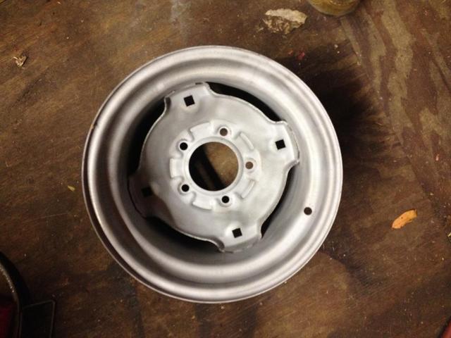

I recently purchased a blasting cabinet and used it to clean paint and rust from two wheel. My problem is with the resulting finish of the wheels. They were left with a dull gray finish that is not smooth. I suspect it is the result of the material I used to clean the wheels.

I was under the impression that glass beads would leave a clean, smooth finish. What I got was a gray, kind of gritty finish. Reminds me of what I got from using sand several years ago with a pressurized outdoor blaster. Am I expecting too much?

What did the wheel look like before you blasted. Glass usually leaves a satin smooth finish unless the metal was pitted.
km3h
I guess I was ewxpecting it to be nice and shiney. When I go over it with sand paper it cleans up and gets a good shine on it.

Theres good news and bad news - Glass, or similar will leave a nice smooth finish but will take much longer to get all that old paint and rust off, while the rougher media - like you got - will take the old finish off much faster but leave a bit rougher finish. I find that a coat of primer will cover that easily and then the finish will turn out fine. In fact I find that even applying the finish coat directly gives me a finish that I'm happy with, course I dont aim for trailer queens but still get some nice finishes. (with Rustoleum)
try lowering the pressure somewhat.
this may help the beads from fracturing into fragments.

I did that before we talked Geno. It got everything clean but left a finish not as smooth as I thought it would. I am going to do another piece and use it as a test. I will prime it and then paint it to see how it turns out. Could be I am just complaining about nothing.
JimD
You should keep the pressure down to 60psi. Any higher and you're just breaking down the glass bead as SOI said. A good #10 glass bead gives a relatively smooth finish that can be primed and painted after cleaning. Finish will come out smooth. :)

60 lbs, now there's something I can live with. That will keep the compressor happy. Thanks for all the advice.

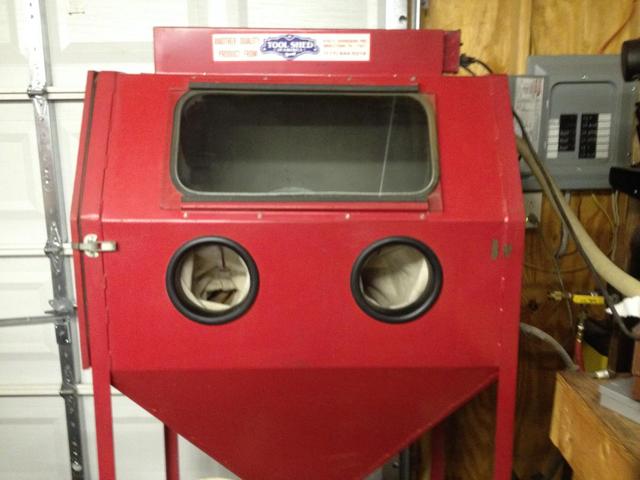

      Soo I was eyeballing one of these for a looong time and finally convinced myself to go out and buy one. What I'm talking about is a blasting cabinet. Although it's a chinese manufactured 'sticker brand' I'm positively suprised by the quality of the cabinet for a price of $140.
      That being said I'm going to replace the supplied airhoses on the gun because they are awkwardly short. Seems to me I cant aim the gun the way I would like to. But we'll get to that later.
      First things first, made a wall mount for it and started assembly:
      Some specs, imperial 'translation' below:
      Dimensions: 23" x 19" x 19.5"
      Air consumption: 5.6cfm
      Next up will be running some power to it for the built in light and connecting it to my compressor.
      Also will need to install an oil/water separator to supply the unit with clean and dry air.
      Will continue after the weekend.

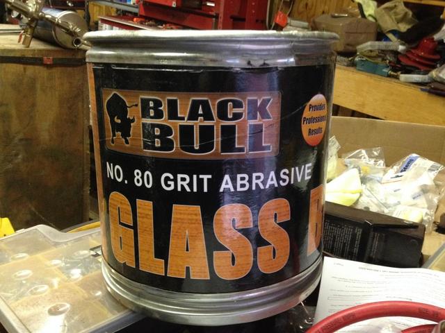

      Yesterday I was using my newly acquired blasting cabinet. I have it hooked up to a vacuum and thought this was good enough to keep from breathing the dust that escapes from the cabinet. My shop is crowded, so I usually move the two tractors that are parked in the center of the shop out the back door and then move them back in when I come inside for the day. Since it is colder now I had both the garage doors closed while I was using the blaster. I am using 80 grit glass beads by the way.
