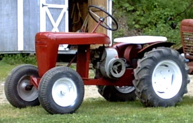

TT-(Moderator) 1,145 #26 Posted December 31, 2014 I'm not a betting man, but after seeing the underside of that hood I would put money on that tractor being the one I rescued a long time ago. It left here around 5 years ago and went to Ft. Wayne, IN. The only picture I could find: Here's a video: 2 Share this post Link to post Share on other sites
Molon_Labe 731 #27 Posted December 31, 2014 Terry I believe you are correct about it being the same tractor, I bought this one from a gentleman in Swayzee, In. this past summer. Even the left foot rest was missing just like the one in your pic. As seen below. Thanks for posting that video!! 1 Share this post Link to post Share on other sites

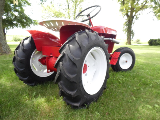

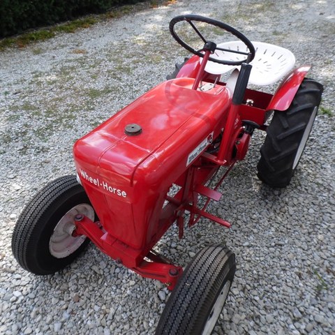

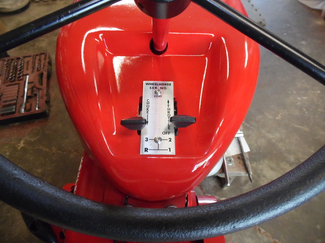

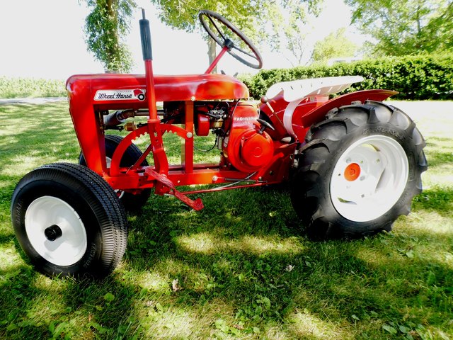

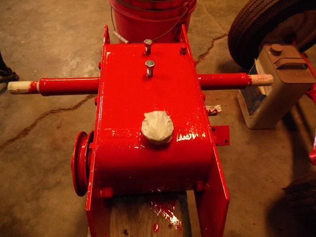

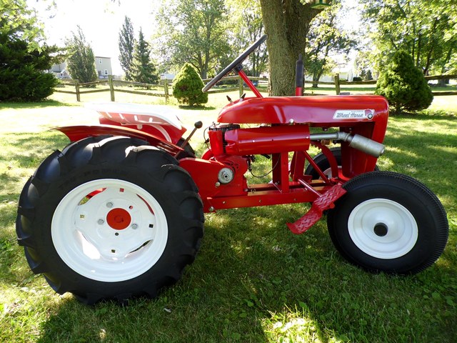

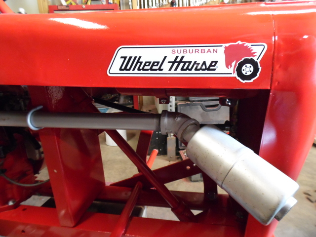

Molon_Labe 731 #32 Posted November 30, 2015 (edited) It has been almost a year now and I've been remiss with the updates. The transmission is back together... Along with the rest of the sheet metal... Just a few minor parts to go including Terry's decals.... A new set of Carlisle's ... A year or so later the old girl is back on her feet.... The heat shield and belt guard held things up a bit but it finally came together. Edited December 1, 2015 by Molon_Labe 12 Share this post Link to post Share on other sites

WHX?? 49,576 #40 Posted December 1, 2015 16 hours ago, Hank01 said: I just read this thread. Awesome job that looks very nice. Me also ....what did you use for honing the axle bushings? I used a brake cylinder hone with 220 grit stones but it seemed to take alot of honing. I had gotten a complete set of bearings, bushing & gaskets from Jake Kuhn for about the same price from motion less the grief of ordering them from motion. Best thing tho I knew I was getting the right ones. He had warned me about the bushings being undersized. Also what what your source on the muffler? Looks reallll nice to us 400 fans. 1 Share this post Link to post Share on other sites

Molon_Labe 731 #42 Posted December 2, 2015 10 hours ago, WHX6 said: Me also ....what did you use for honing the axle bushings? I used a brake cylinder hone with 220 grit stones but it seemed to take alot of honing. I had gotten a complete set of bearings, bushing & gaskets from Jake Kuhn for about the same price from motion less the grief of ordering them from motion. Best thing tho I knew I was getting the right ones. He had warned me about the bushings being undersized. Also what what your source on the muffler? Looks reallll nice to us 400 fans. Those axle bushings took a bit of work to get right. Ended up using 150 grit emery cloth taped and wrapped around a deep well socket to hone them out. The muffler in the pics is just a 3/4 npt B&S type but has been replaced since with one of these 1 Share this post Link to post Share on other sites
Molon_Labe 731 #43 Posted December 2, 2015 (edited) On 12/1/2015, 12:24:45, stevasaurus said: It does look sharp...nice job. Any problem with that 3rd gear?? Thanks Steve! No issues at all with the transmission, 3rd gear is solid as a rock, did build up the shift forks and test the detents before putting it all back together to make sure the gears were engaging fully. I would much rather work on a 2 piece transmission any day! On 12/1/2015, 10:26:10, Racinbob said: I'm happy to see that I'm not the only one who take a long tome to do a resto. Outstanding job Thanks Bob, you were a great resource with this one. I'm too old to get in a hurry these days which is why I've been over a year getting this thing wrapped up. That and trying to round up all of the missing bits and pieces, kind of like a non-stop treasure hunt. Edited December 3, 2015 by Molon_Labe Share this post Link to post Share on other sites
