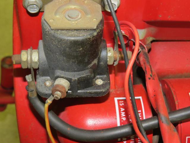

rustykan 140 #1 Posted November 6, 2014 Would the starter solenoid on my C-120 be a standard 12V solenoid? Looking up the Toro part number, it lists for $50 and up. I was going to replace mine just for cosmetic reasons, but not for that price. I will try to restore it if I have to, but if I can get a new one for around $15, why bother. Share this post Link to post Share on other sites
rmaynard 15,265 #2 Posted November 6, 2014 (edited) They are 12 volts. If you have a TSC near you, they sell one just like that for about $10. NAPA Auto Parts also has them for a little more. http://www.tractorsupply.com/en/store/buyers-motor-solenoid-12v?cm_vc=-10005 Edited November 6, 2014 by rmaynard Share this post Link to post Share on other sites
Save Old Iron 1,565 #3 Posted November 6, 2014 From my experience, your relay clocks in about an 8 on a cosmetic scale 1 -10. If cosmetics compel you into restoration action, just take a soft brass brush and clean up the metal contacts and bracket. Clean the plastic body and give it a quick mist coat of gloss black paint after taping off the metal parts. Reliability wise, unless you have known electrical issues with this piece, you may be much better off with your current relay than a $10 import. Share this post Link to post Share on other sites
doc724 924 #4 Posted November 6, 2014 That solenoid looks darn good to me, but in your pix, there appears to be a nut missing on the right terminal. Share this post Link to post Share on other sites
rmaynard 15,265 #5 Posted November 6, 2014 That solenoid looks darn good to me, but in your pix, there appears to be a nut missing on the right terminal. ...and the battery cable. Share this post Link to post Share on other sites
rustykan 140 #6 Posted November 6, 2014 That solenoid looks darn good to me, but in your pix, there appears to be a nut missing on the right terminal. This photo was taken during the tear down process, that's why the nut is removed. I have repainted everything else, that's why I wanted to do something with this. Share this post Link to post Share on other sites
