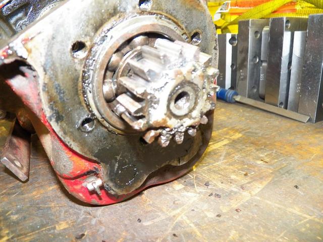

Cst,  this is the gear welded to my tranny.  I believe it was done by the Ponds during original assembly. IMO, it looks like Brians may have been disassembled at some time to replace the bearing ??? then re-welded.
 again, only my opinion.

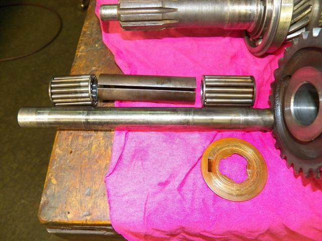

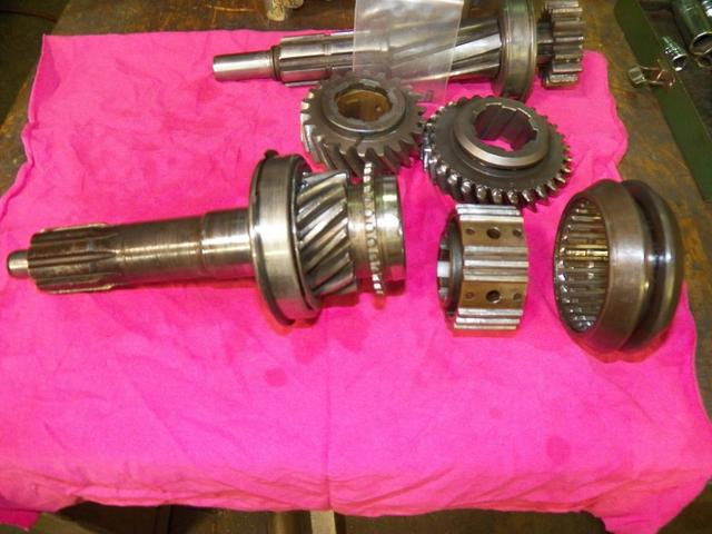

here's all the parts
post-591-0-03249300-1418423877_thumb.jpg post-591-0-70639300-1418423986_thumb.jpg

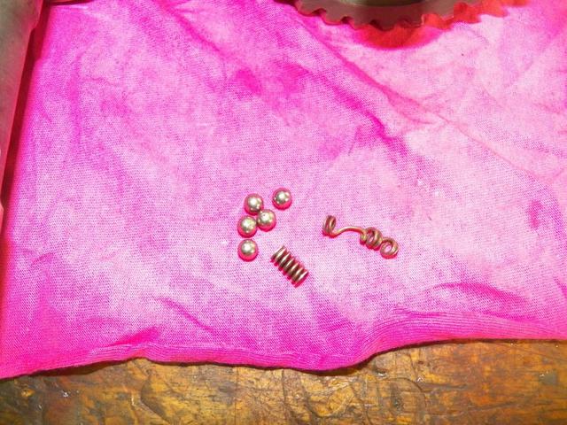

here's what is left of the balls and springs
I need to find out what the bore ID is stock on the input shaft and the OD of the output shaft for the caged roller bearing these are very loose fit together
Dan
Quite possible it was done that way for WH / Pond. Unusual but possible

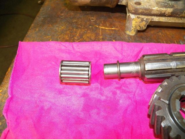

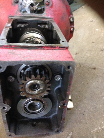

here's my pinion.
What bothers me more is what's controlling fore and aft movement of the mainshaft. The bearing looks to be held between the 2 gear cases by the retaining ring on it, but the splined shaft is a slip fit in the bearing bore.
It can go back until the helical cut spline shoulder contacts the bearing and can slide forward toward the synchro rings like brian showed

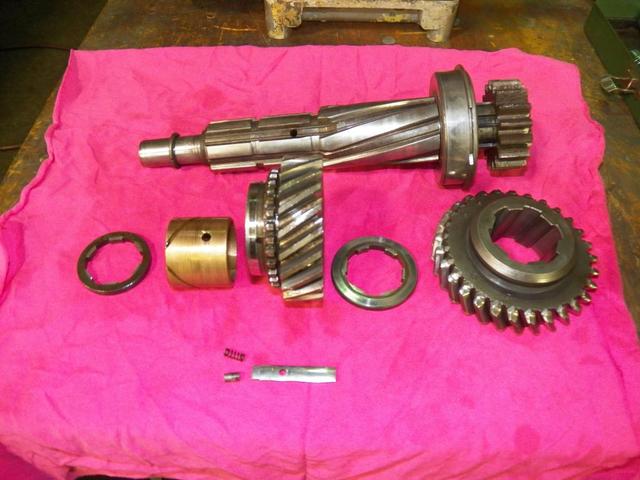

Looks like the earlier style synchros with 2 balls 1 spring and thicker slide gear. Later ones used 1 ball
Don't lose the round space on the mainshaft it sets endplay

I'll go with my gear being rewelded back on I said someone had mine apart before and maybe they changed the bearing
sure looks like a bird pooped on it
Brian
Good news is you can grind it all off. Just a lil work is all

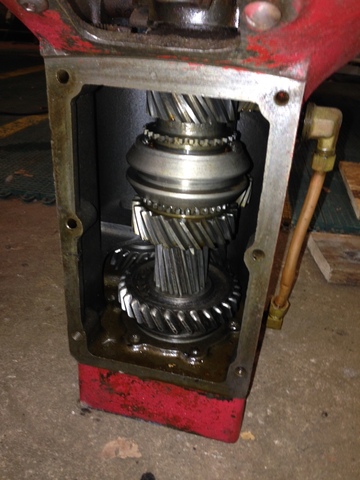

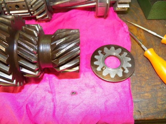

here's something interesting.... Brians gear cluster has all beveled gears. mine has beveled and straight.
 post-6671-0-28302800-1418428992_thumb.jp
cstempert
The earlier three speeds (32-35) had spur cut low and reverse gear. Your mainshaft should have straight splined, later are helical cut
Yours is obviously an early one and Brian and I have later 36-39

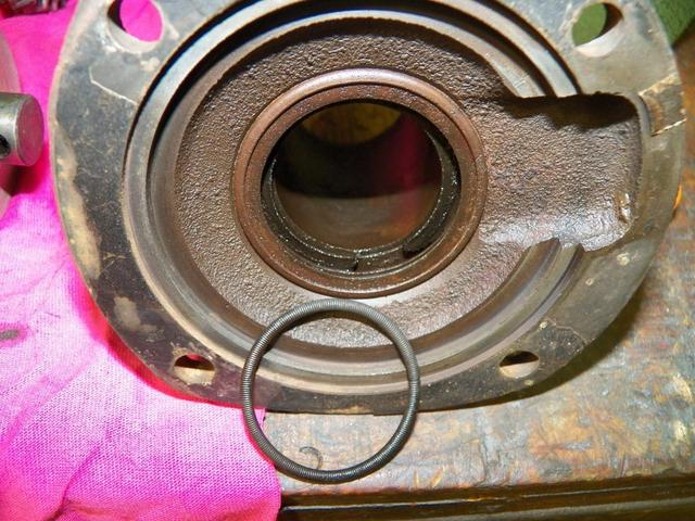

front bearing cover you can see the seal is damaged

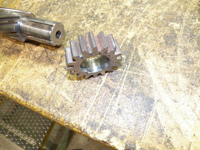

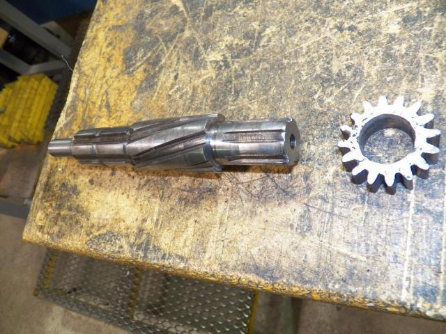

just showing a picture of the gear removed from the shaft. Work has been slow as I am purchasing transmission parts

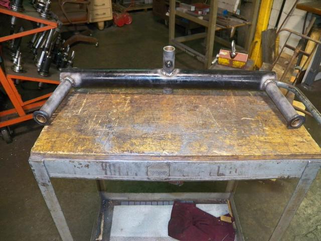

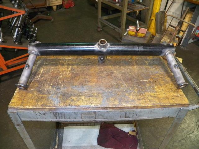

I mentioned in a earlier post that I had bought the pipe I needed to build a new front axle well here she is

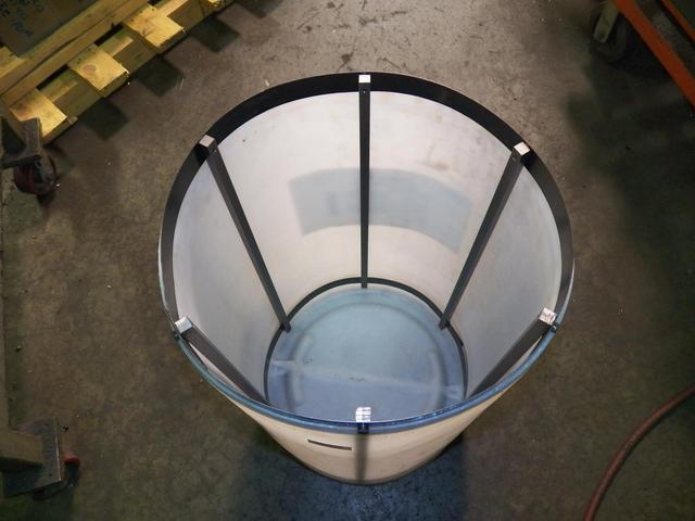

also got my e-tank ready to go
all I need now is water and washing soda
